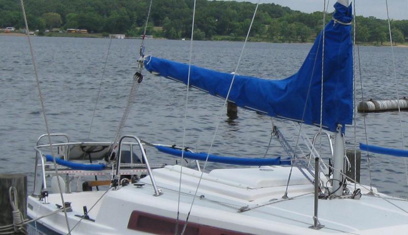

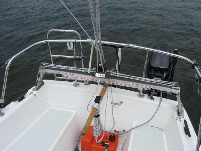

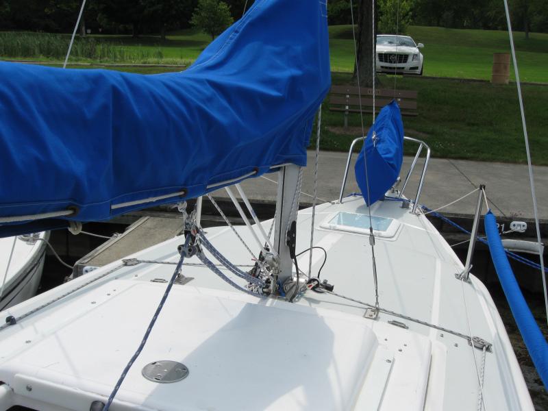

I bought a Macgregor Venture 21 mid season last summer. It was set up with the mainsheet mid boom and a traveler at the forward end of the cockpit. It has no boom vang. With all the discussion about the importance of a boom vang in sail trim, I would like to add one. So if I add a boom van mid mast and move the mainsheet to the end of the mast, is there any value to attaching the boom vang to the traveler or should I move it to the back of the cockpit?
Enclosed are some pictures of the setup I have on my MacGregor 25.
07-31-2014 009.jpg Hope the photo's help
End boom traveler, boom vang and boom kicker.View attachment 83854
View attachment 83855 Hope the photo's help
looks to me like you already have a boom vang and your main sheet is at the rear of the boom now...unless in 5 years here i haven't learned anything
The original post was JoeSailor seeking info on boom vangs for his Venture 21.
The pictured Venture 21 belonged to Mac 25, where he was showing his setup should JoeSailor opt to convert to an end boom sheeting/traveler system.
So, the purpose of your comment is????
hummm looks like i got the two boats cornfused thanks for pointing that out.......
Joe
Jun 1, 2004
8,189
heh, heh.... happens to me all the time, my friend. We ain't gettin' any younger.

Albrazzi
In answer to your question.
I made the traveler with over the counter parts.
Lewmar size 1 traveler kit.
Garhauen UR-1 universal risers
Aluminum square tubing.
There are brackets that attach to the bottom of the traveler
to the stern rail risers for more support, that are hand made.
The setup was easy to make and easy to install on the boat.
I use the boat 3 days a week, so I do a lot of solo sailing.
So I wanted the traveler where it was easy to use.
It was worth the time and money.

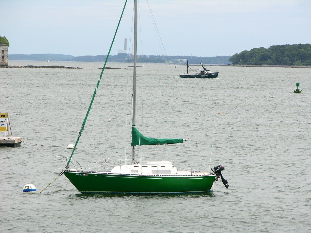

Jul 27, 2012
13
C&C 24ft PORTLAND ME
My C&C 24 had a modified Crosby mainsheet traveler - see photo- which I was going to replace until I realized that a rail system would restrict access to the cabin or encumber movement towards the stern (if I ran it off the end of the boom). It worked fine except for the rise of the boom when the main sheet was payed out. I Installed a separate bail on the boom and attached a double block and a fiddle block with a cam cleat at the base of the mast. Works fine
