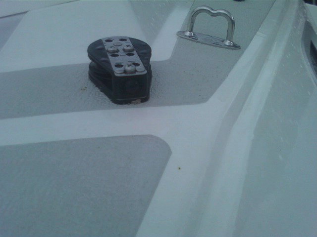

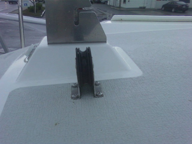

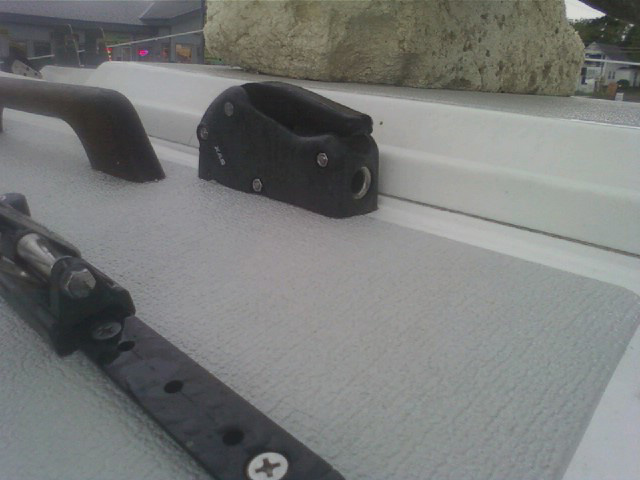

Here are some pictures
They are not from my boat but I used them to lay out what I wanted to do. They are also from a Precision 21.
First the Halyard block lined up with the pulley in the mast;
Second picture is the cheek block for turning the corner. This is from the bow looking aft, the bump is from cabin hatch just behind it. Note I installed this last on my boat.
The third picture is the rope clutch between the hatch and the handrails. If you have winches on the cabin roof you want these to line up with them. This way you can use the winches to do the last little crank on the sail to get it raised. Pictured are Ronstans but I used Garhauers.
So what I did was install the halyard block and the rope clutch first. Then I placed the cheek block in the approximate position and then ran a string from halyard block through the cheek black to the clutch. I moved the cheek block around to make sure the rope would make the turn cleanly. I marked the location and installed it. Note I was able to get a hold of some aluminum plates for backing plates.
