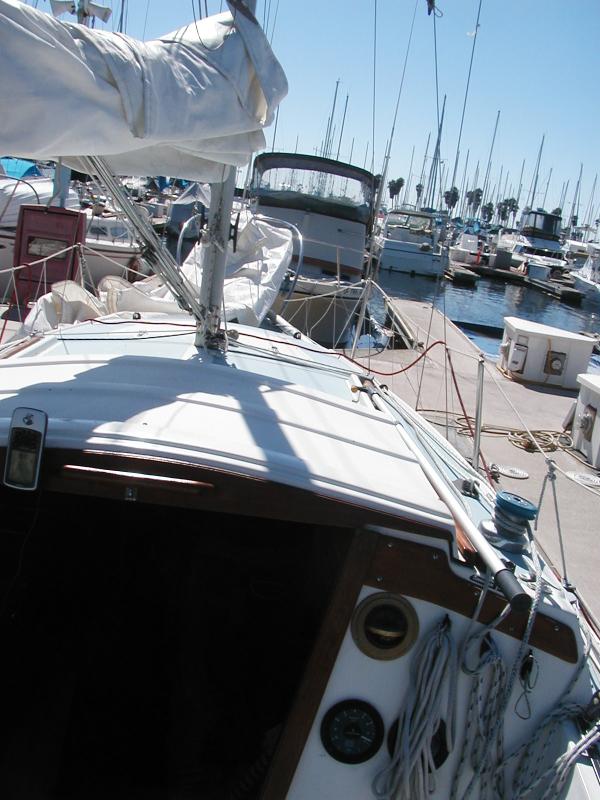

The rigid vang requires a strong, saddle like, bracket fixed to the mast... the vang has a heavy hinge like fitting that connects it to the mast bracket. A bale will not work. A soft vang does not support the boom, a rigid vang does and requires a substantially more robust fitting.
Like I said, drilling holes in your mast, or your boat, for that matter, is something everyone has to do to make their vessel their own. Drilling a few holes in that heavy aluminum extrusion will do no damage, in fact you're going to be filling the hole with strong bolts or rivets, so what's the big deal? If you have unused, existing holes you can fill them with epoxy type products, such as Marine-tex, developed especially for aluminum repair.
The pictures are not that good, but you may be able to make our the mast bracket in the first one, the second shows the luff channel, and a few padeyes secured in it with self tapping screws (you can even see some empty holes...notice that I'm not particularly concerned) The top one anchors the cunningham, the bottom is unused.
