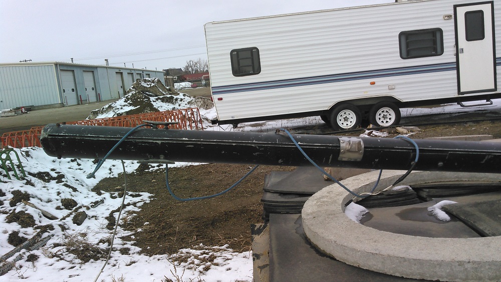

Rob thanks for that reply, it will take me a bit to digest it and google some of the terms but I will work on it during breaks in the restoration this weekend. I will also try and get a pic of my boom and the attach points. The one in the pic is not mine. I do not have any with everything set up as I just got this boat three weeks ago.

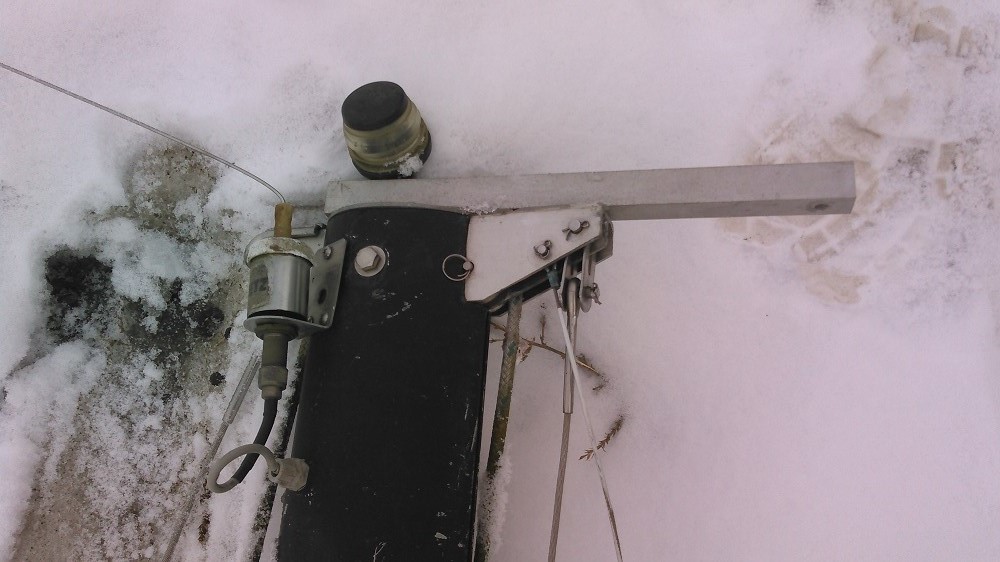

No I do not have a rope vang, or at least not the pulley parts. It may have the attach points on the boom. I will post a pick of it later. This boat was in sad shape and did not come with everything I am afraid. I only have a main sail but it has two reef points. Shows the topping lift I think.

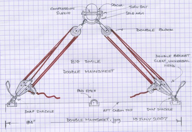

You could easily convert to a two sheet system and add a Boom Kicker to make a rigid vang.
I think that's a great idea. I suppose if I were a racer or sailed where I had to tack every few minutes I'd probably want a traveler. As it is I use a twin mainsheet system on my 26D and it works quite well. I prefer it over the traveler because it doesn't crowd the cockpit or the cabin top. Trimming is not as straight forward as a traveler but it does offer all the same sail trim for a whole lot less expense. Since you already have a topping lift a kicker isn't all that necessary.
The tail could easily be routed back to a winch or cam cleat rather than cleated as in the drawing.

Thanks Bud, All I have to do to incorporate that is install another cam cleat on the other side. I have one on the starboard side just aft of the cabin. as long as I am over drilling and filling with epoxy I can do the port side as well.
Thanks for the drawing makes it easy to understand.
