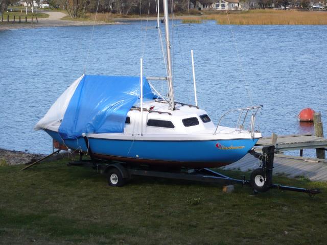

my main objective is to keep snow out of the cockpit. the deck seems to handle things on its own. Here is a picture of my set up with cheapo tarps. I too get about 3 seasons out of a tarp, with its last duty being a drop cloth for the 'every four year' scrape the bottom job.

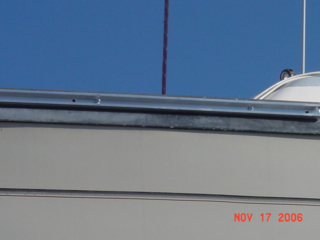

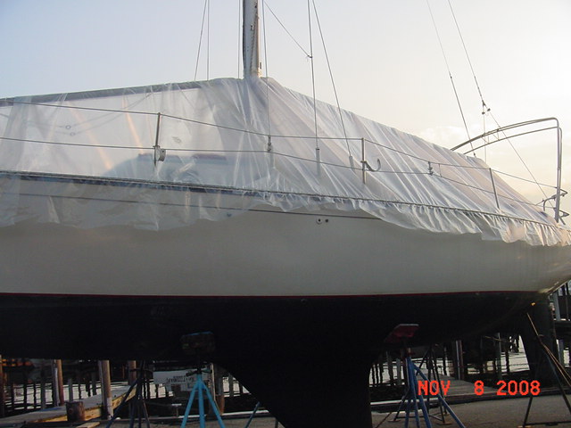

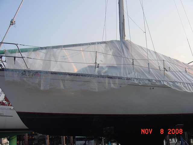

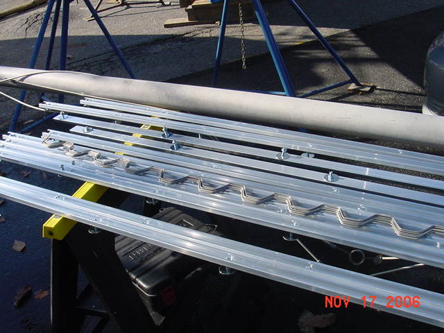

Bob- I have a tie down method you may like for your tent. Look at the post for the Meant to Be on the Hunter Churbini section of this site. I have also attached several photos from this application. You have an open toe rail similiar to my Hunter 30. I bolt on an aluminimum greehouse wire channel lock on the outside of the toe rail and lock the poly in this channel using a zig-zag wire. In the spring, you unlock the zig-zag wire and out comes your tent. You can use this system for years. Material cost is under $100 for channel, wire, nuts, washers and bolts. You could hang your cover an then go round and apply the wire to pull tight. This way the snow load should slide over the toe rail. Might make your year end go quicker.

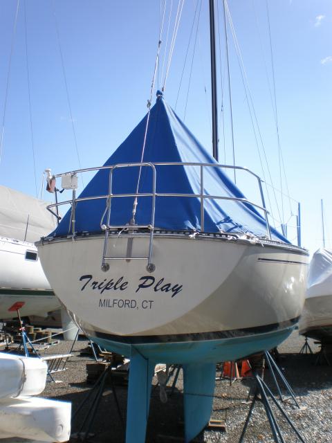

Thanks for all the interest and tips. Fortunately snow load doesn't seem to be too much of a problem in Winthrop. I have backed out of my driveway 30 miles east with over a foot of snow piled up and upon arrival in Winthrop found nothing. Triple Play has slotted toe rails, but the sides of the deck seem to drain much better than my Lancer 25, on which water used to pool amidships and freeze. There is no way for the water to get into the cockpit, to my knowledge.
Ian, I certainly agree that having the boom tent extend beyond the toe rail woud be an improvement, but it doesn't and is prevented from going lower by the fact that it rests on the boom. It would be nice if there were flaps that extended over the grommets in the cover and over the side of the boat. That would allow snow to run off, but maintain connection to the toe rail. I love your greenhouse channel lock solution.
