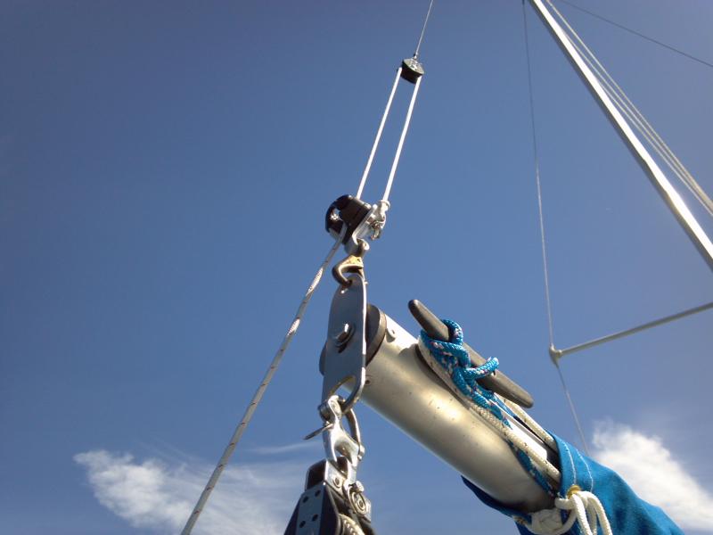

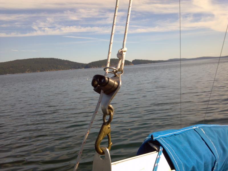

on a mac25, the dry weight of the boom with the sail furled, the aft end weighs less than 10lbs. hardly nothing, so when there is a stretchy nylon line tied to it as a topping lift and you have much wind, the windage of the line can cause the boom to lift a bit... and yes a vang will prevent this.... but not all of us had a vang on our first boat, until later.
and im NOT guessing about this, as I had a boat that was rigged with a nylon topping lift... it really doesnt work too well, as opposed to the method i changed it to.
others may disagree, but I have a strong dislike for a stretchy topping lift line.
so when there are options available and the cost difference is negligible, why not go with the best product for the task?... and even if the OP chooses to stick with his nylon line, I will always offer the best information as i know it from experience.
