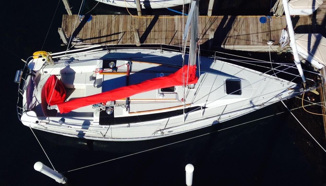

20141011_185901000_iOS-3.jpg I have a 4:1 tackle that I use to hold my boom to the side and to prevent it from swinging while at anchor or dock. When sailing down wind, I will use it as a preventer, moving the lower connection point forward on my toe rail.
I have also practiced a controlled jibe, so I can jibe, even if I the boom extended, when necessary.
I have an O'Day 322. Not sure of the boom length.

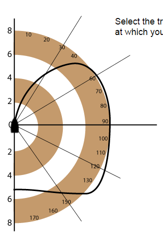

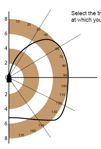

I'm going to bet that that polar does not include wing-and-wing. This one does. There would have to be a bump. The deeper you head you go slower and slower... until you jibe the genoa over and catch air on the opposite side. There logically has to be a bump.
This speed polar has 2 distinct differences from the prior example. This boat has more of a reaching bulge (catamaran), and it has a bump for wing-and-wing. The result is that wing and wing is not the fastest course, but that it makes sense as soon as the course is too low for good reaching.
Also note that like many cats with swept back shrouds and no backstay, we can't ease the boom all the way. This limits deep reaching unless we are wing-and-wing (which we can do without a wisker pole) or carrying a chute.
I think you will find most non-spinakar boats race down wind wing-and-wing.

You guys a cracking me up.... our newbie barely understands the basic parts of a boat and your start throwing polar charts at the poor guy. :clap:
lol... I think the polar charts are for us old guys who still try to glean a little information here and there. I, for one, can learn a lot more from reading a few charts than I can from an entire book. It's like they say "A picture is worth a thousand words."
Sep 25, 2008
1,096
CS 30 Toronto
I was a newbie at one time until someone throw me a polar chart and tried to understand it all. Over time, you'll get it if curious enough.
Like I just learned the "Bump" today.
