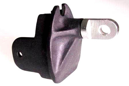

Cause my boom gooseneck casting looks like this (where the silver end swivels 360):
