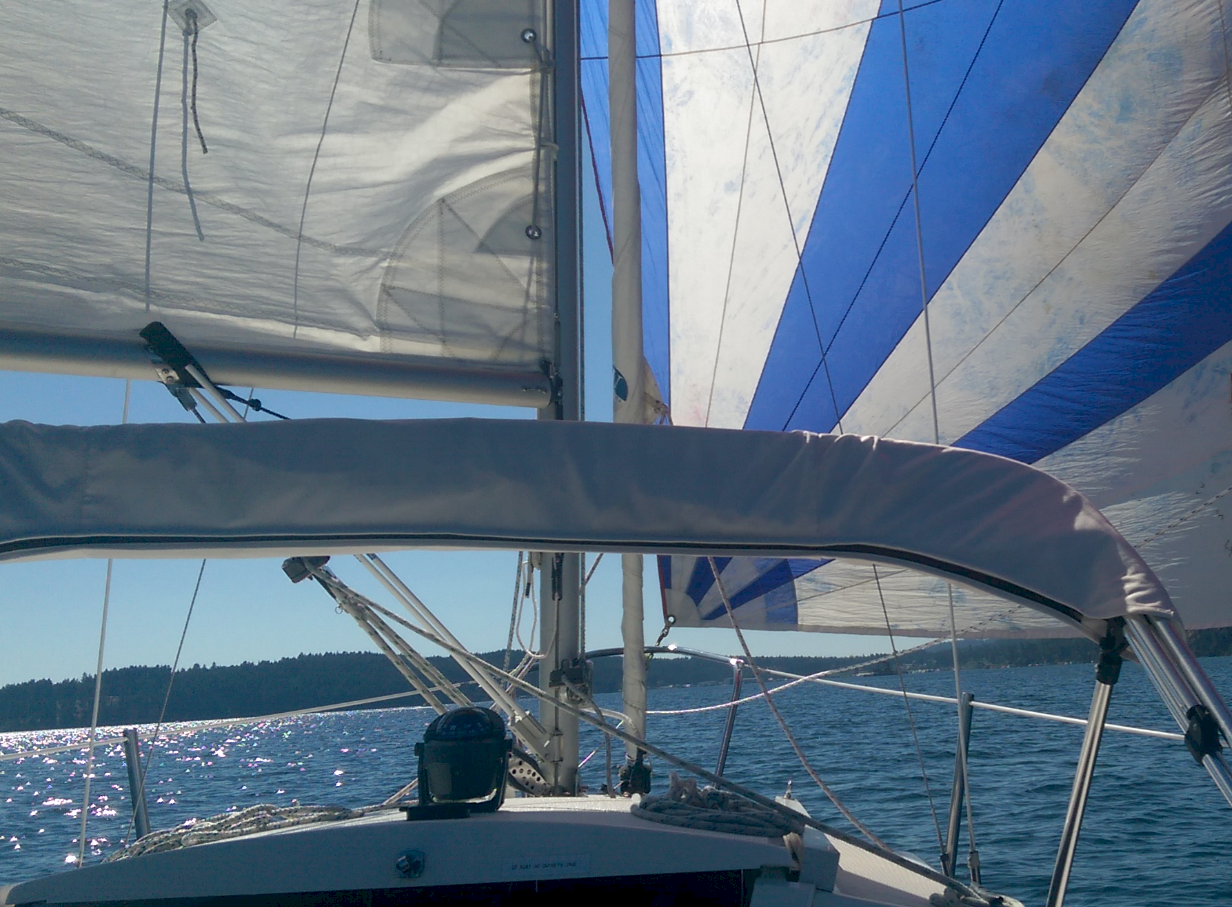

The gooseneck fitting on your boom needs to remain in the track for certain. My Catalina Capri 18 rigging has the boom just below the mast track access area and uses a track stop just before the mast track opening. I do not know about a mast gate feature that Joe mentions in the earlier response, but I guess it could be used after some modification to the mast.
When I raise the mainsail to the highest level, the boom gooseneck slider raises to the track stop. I also use a boom kicker for better boom position control. Here is the best picture that I have to show my current rigging.
Happy sailing...

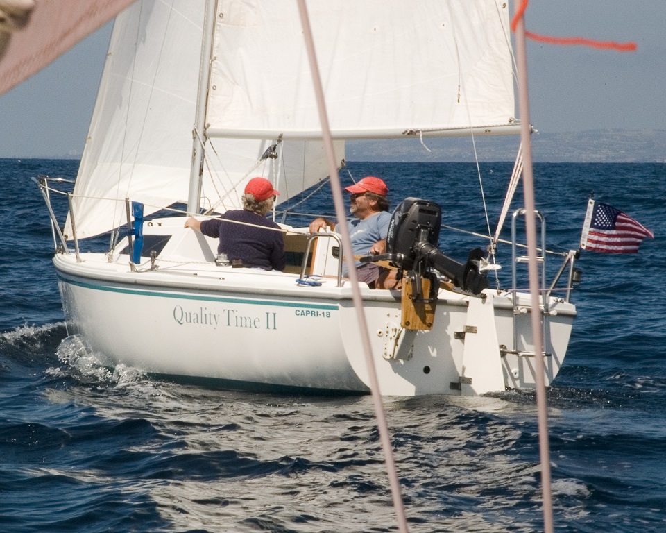

I used two track stops, one would be the lower stop where I would secure the line from the bottom of the goose neck to the cleat on the mast slot. The other stop would be installed in the mast slightly above the slot so the sail wouldn't fall out of the slot. If you hoist the main sail all the way, the leech of the sail tends to catch on the back stay and can wear the sail. So I hoist the sail so it wouldn't hit on the back stay, and then pull the goose neck down, now tighten the stop below the goose neck real tight and just leave it there, no need to mess with it again. Now when rigging, all you have to do is slip the goose neck into the slot, let it drop to the stop, and secure the line below the goose neck to the cleat. Now you can hoist the sail and not have to worry if you're hoisting the sail too high,
Don
You can see the stop below the goose neck and the line secured in the jam cleat
Keeping the boom lower also helps prevent the end of the boom from hitting the backstay. This is why a vang is so important on both the Capri-18 and the Catalina-22. It doesn't take much lifting for the end of the boom to snag on the backstay.
