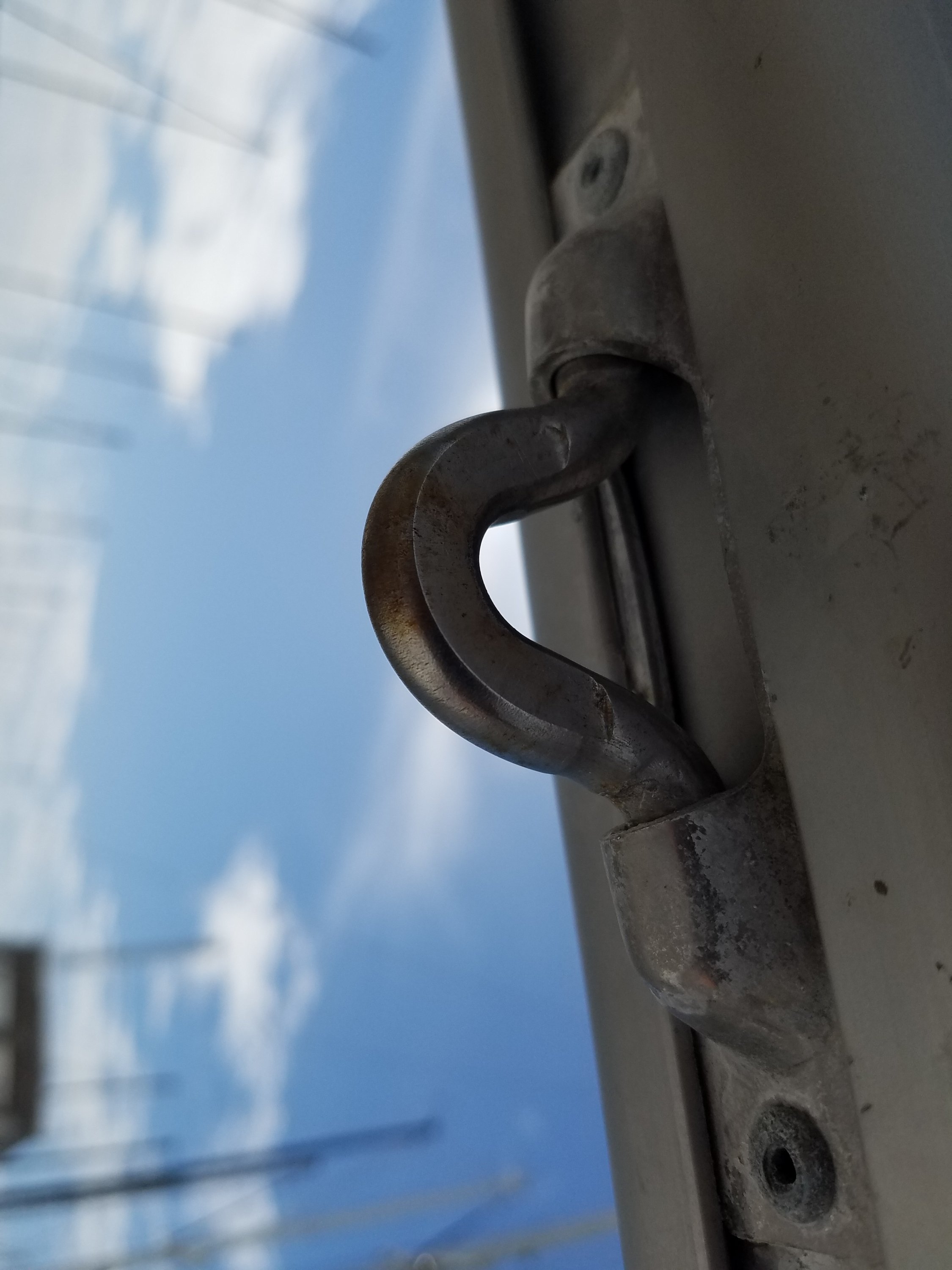

My boom connection to my mainsheet has corroded and impossible to move to a new location as it is too far forward. Therefore, I am looking add a new boom bail with the bail plate. It is referred as a NGII Bail 47505558124 and NGII BAIL PLATE 47550553407. Does anyone know where I might find a place to purchase these parts?

@Ench2456 from the image it appears to be riveted into the base of the boom.
Why not drill out the rivets and replace with another fitting.
Something like this.
http://www.rigrite.com/Spars/SparParts/Boom_bails.php
Internal Boom Bail - 5/16": K-11428:
