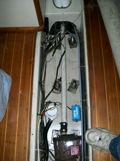

removehtml]Bonding Issue Ok I have an issue with my bonding system. First of all my bonding plate is not big enough so I have to figure out what to do there. It is only 3 x 9" right now. Also my mast has never been bonded to it, the chainplates however are, also the length of horizontal run from the main mast to the bonding plate is 20' and passes between both my fuel tanks which are fiberglass and 18 1" SS keel bolts, then under the gen set and engine to the bonding plate back at the shaft tube. I will post two pictures to show some of this. My concerns are 1) The horizontal run is not a vertical one like every book suggests. 2) The run would be laying on the bottom of the hull ( could it blow holes in it? ) 3) It would run between the built in fiberglass fuel tanks ( dosent seem to cool for the same reason ) 4) Past all the keel bolts, under the genset and engine. ( All atractive metels ) 5) Best way to increase, and secure a larger bonding plate and made out of what material? ( origional was only secured with 2-1/4" SS thru bolts about 5" center to center with no backing plate just small SS washers ) All advice is welcome. Thanks PS: I am standing on the starboard fuel tank the port is opposite it. Error: Error: expected [/URL], but found [/removehtml] instead[/removehtml]
