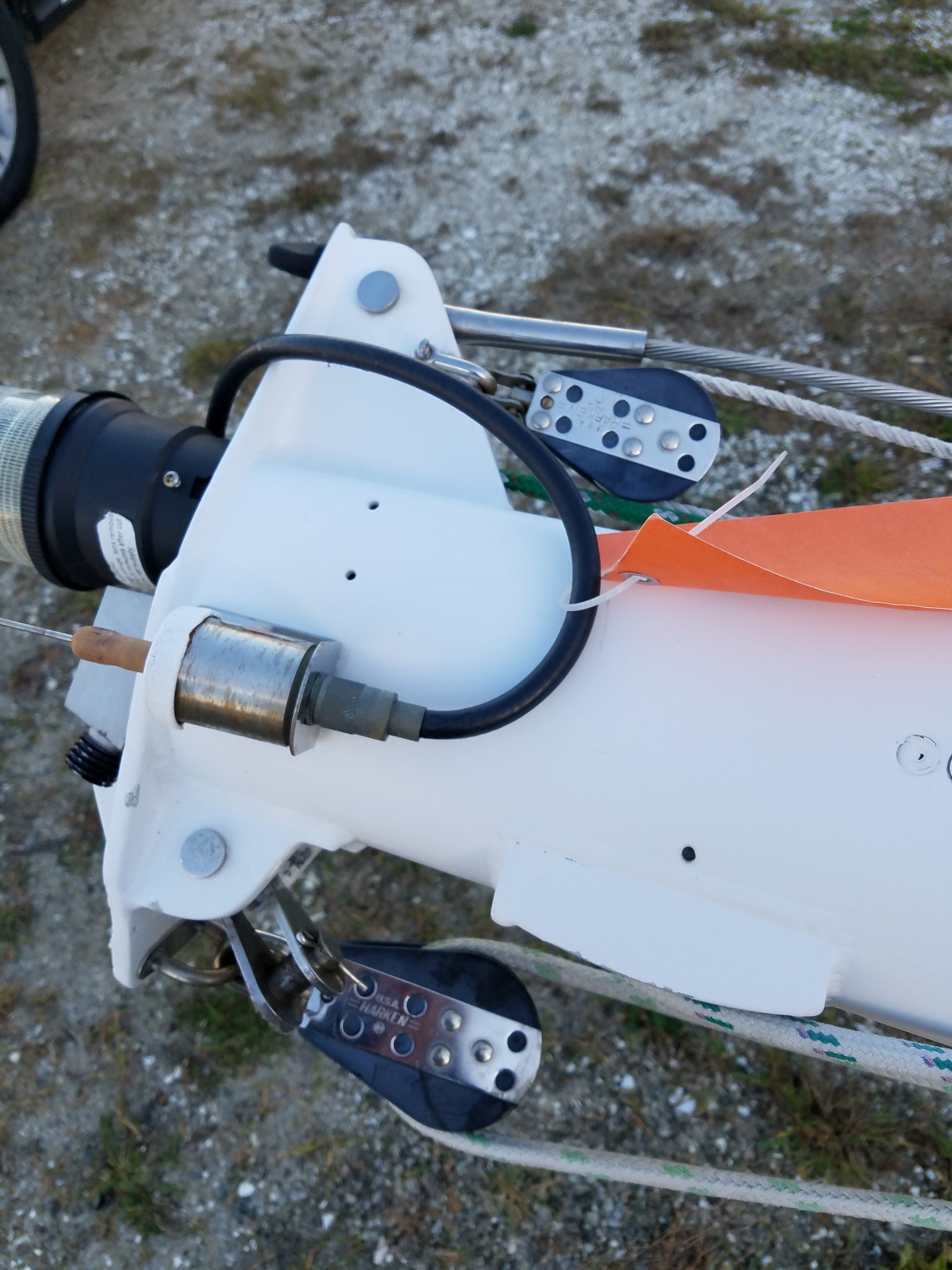

Here's mine. It looks like the shield is connected to the bracket, which is connected to the mast.

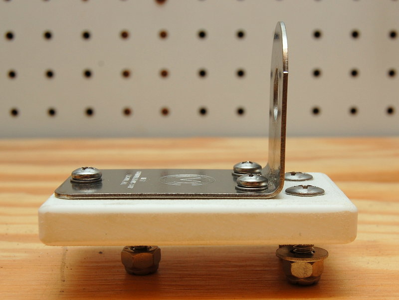

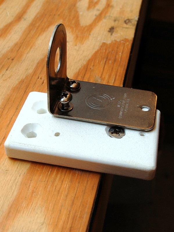

Isolating the braid of your coax from the spar is not very difficult..

Seeing as most boat owners do not have an SSB I will let the article explain this, and it does so quite well. An easy and very inexpensive fix to isolate the VHF whip from the spar is shown above.

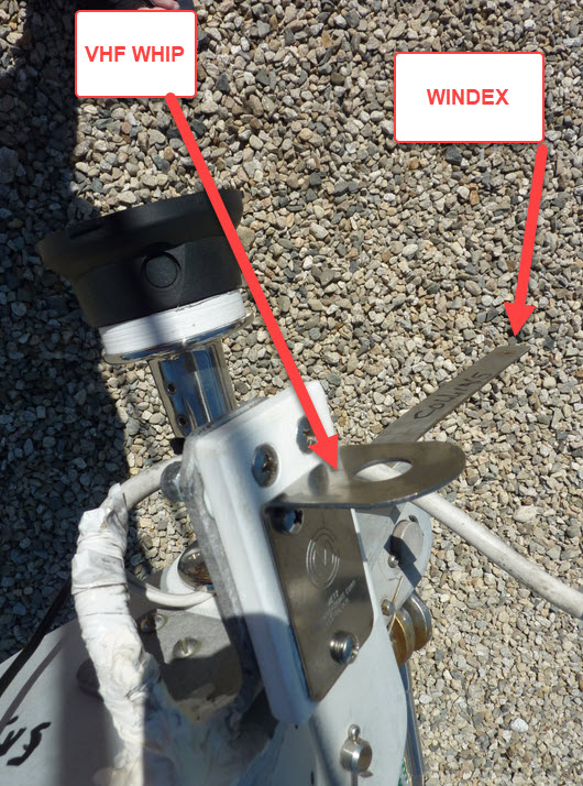

Thanks as usual for the thoughtful replies. I have a followup question for you (and anyone else who cares to jump in), as I am trying to implement the recommendations in the article but running into some difficulty. My current setup has a 4 AWG wire running from the base of my keel stepped mast to the nearest keelbolt (which is silicon bronze) on my external lead keel. I've run into some corrosion problems and the consensus is that the VHF is the culprit (although now you have me worried about my bilge pump too).
In order to remedy this, I have fabricated a new VHF mount for my masthead out of some scrap G10 that I had lying around, so once that is installed this spring I will have the VHF mount at the masthead isolated. So I think I have that in hand.
However, Stan also suggests installing an "inner/outer DC block" in the VHF system. I have not been able to find a commercially available inner/outer DC block, but Polyphaser does make a block that prevents DC current on the center pin of the VHF cable -- See https://www.polyphaser.com/products/rf-surge-protection/is-50ux-c0
I recently purchased one of these to install, but the instructions indicate that you have to ground it for it to work. I spoke to tech support at Polyphaser, and they said they recommended a 6 AWG wire in order to shunt any lightning strike, tied into the existing lightning protection system. In other words, they want me to wire this to the 4 AWG wire running from my mast base to the keel. My concern with this is that if I wire it like this, the coaxial shield would then seem to be connected again to my mast/keel, leaving me with the same corrosion issues. Am I thinking about this correctly? Or, if I have isolated the antenna at the masthead, should I just call it good and not bother with the DC block? Alternatively, should I install the DC block but not ground it?

That makes a lot of sense to me, having read the article. I have never seen it done, though. Is the antenna mounting bracket really electrically connected to the shield of the cable? It shouldn't be, according to best practice for coax cables and shielding.
I have done this on over 40 boats.. simple and effective but it is not done for lightning purposes. Lightning gets what it wants. Just keep your policy paid.
