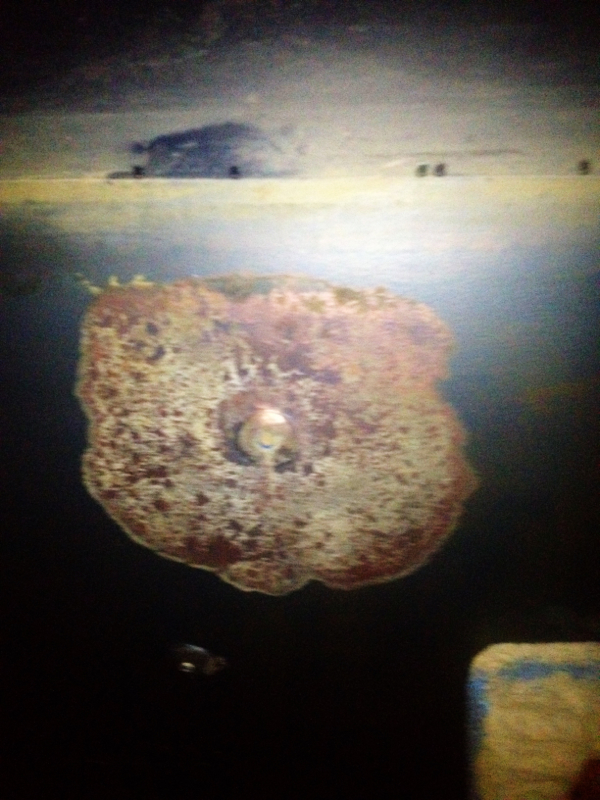

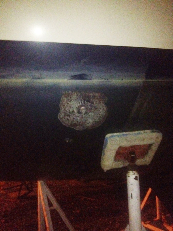

As to the paint - two questions: what is the hull made of and did the paint fall off altogether or is there still paint under the effected area ?

The hull is fiberglass. And it did appear the paint was gone. I think what is left is barrier coat and maybe paint remnants. The through hulls are marine grade bronze. The brand escapes me but it was one of my first stops looking at the boat. My first guess is Conbraco but I'd need to double check that. I haven't been on my boat in months.

The paint failure photo looks more like the coating underneath the VC 17 failed and carried the VC 17 away with it. If it were DC current, I would expect the process to stop once the paint fell away such that the paint was no longer touching the metal through hull. Also the outer edge of the failure is looks very abrupt - not a gradual fade into the intact paint.
Find out what is between the bare hull surface and the VC17? Is there a barrier coat? Was the hull painted with something else before VC 17? Were the metals cleaned and epoxy coated before anti foul was applied?

There is a barrier coat under the VC17. As far as I know and have seen there hasn't been anything else. And no he underwater metals were not cleaned and epoxied. They were taped off though. I will be cleaning them up here soon and doing just that as soon as it is warm enough.

I don't understand "taping off."
If you tape off the exposed metal and paint -- then when you pull the tape you have a fragile broken edge Water can/will get under the new paint.
An epoxy (barrier) coating over the metal surface extended onto the hull surface, followed by top coat of anti foul over the hull and the fitting guarantees water cannot get under the paint nor between the fitting and the hull surface either.
The tape, paint, pulling tape method creates a pathway for water to get under the hull paint.
By the way anti foul will not harm bronze through hulls even if you did not coat the metal with epoxy first.
