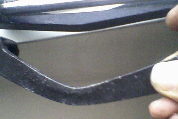

My 86 Hunter 31' came with Bomar hatches. The forward hatch has supports on each side. They consist of an angled arm bolted to the fixed hatch frame, and a rod that slides in the arm. The rod is bolted to the moveable hatch frame. The two arms are different angles. Starboard is a larger angle and works fine. The port arm has the sharper angle that catches the rod on its way down. Possible the PO changed the port arm and got the wrong one. Is there a source other than Bomar for used arms? The arms appear to be too brittle to bend.

No, Dave, they are different. After struggling and lubricating, it finally occurred to me that the port side was just not going to work and I took off the arm. That's when I realized it had a substantially sharper bend than the starboard side. I have been using the hatch with just the starboard support [the cabin hatch only as one], but figured there must be 2 for a reason. I will get a picture of the proper support and try all the used suppliers I can find. Will also post a picture of the improper one which will be offered free to anyone in need.

Well, I got an answer from Bomar after sending them the attached picture. I quote, "The arm you have is bent. We suggest replacing the arm with part number P100-20 (right) or P100-21 (left) for $82.00 each." Now I definately don't want to seem ungrateful because responding to my request in the first place was very good of them. I wrote back, "Wow, Tracy! If I correctly read between the lines, you are saying that Bomar never made an arm like the "bent" one. I had assumed the hatch was accidentally assembled by Hunter using an arm designed for a smaller or larger Bomar hatch. I could be wrong, but the Bomar arms are wonderfully heavy duty and look far too brittle to bend. Given the strength of the arm compared to the rod mounting screw and the frame itself, I can't imagine how one could bend the arm before tearing out the mounting screw or bending that hatch frame. It's a mystery. Still, I do appreciate your consideration and analysis."
Am I crazy, or could this arm actually be bent??
