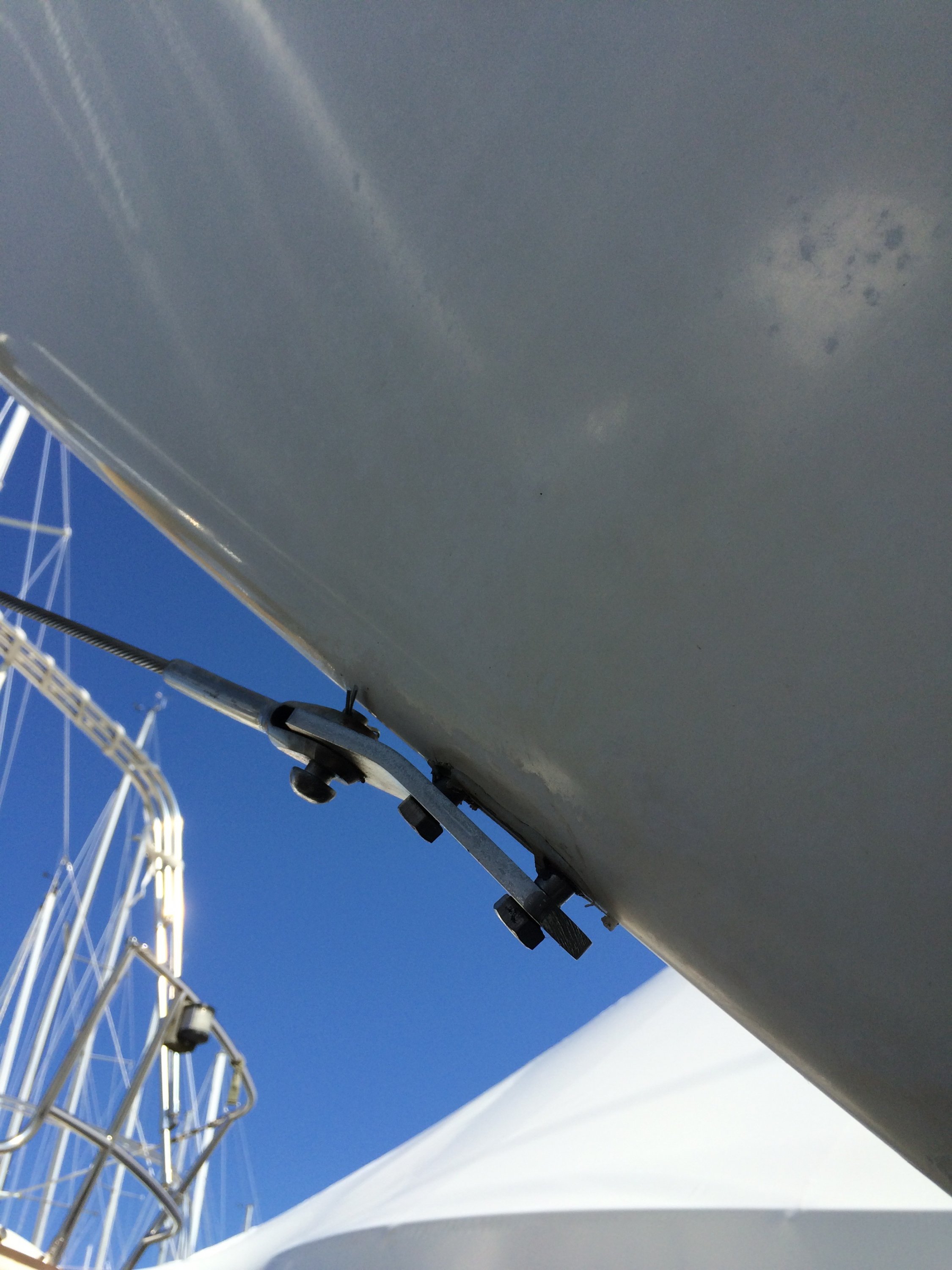

Yes, I have a Cat 30 and did the same procedure but used a block of hard oak cut into a "V" to fit in the bow.
The factory wood block was mush after 30 years.
However as Kingjim91 states if they have delrin replacement that would be good also.
You need a friend on the outside of the boat. You on the inside with a ratchet and simply pull the bolts, insert new block of delrin or oak, as in my case, re-insert and tighten up. Seal with appropriate sealant between inside and out side of bow.
