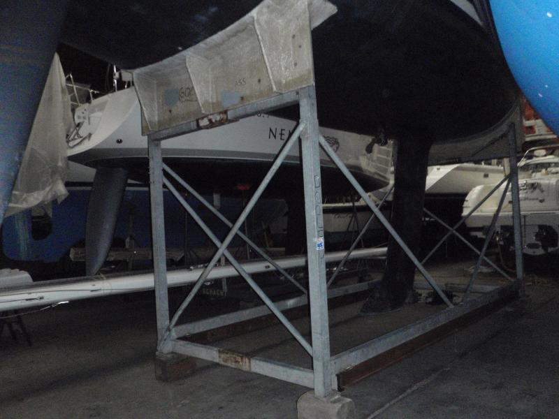

Not a bit Bill. I looked very closely! Nothing under the keel! Matter of fact I was so impressed that I took a picture. I have attached it. Look closely and you will see no support under the keel. Since that time I have seen a few more in yards with suspended, unsupported, keels. Just a few weeks ago in the Annapolis Boat Yard I saw two.

Some boat can't be stored with the majority of their weight borne by the keels (swing keels, deep fin w/bulb keels, etc.). These boats have to be stored with the majority of their weight borne by strategically-placed pads/bunks, which work in concert with the interior hull support/structures.
You'll notice in Nodak7's picture that the boat isn't supported by four or six 1' square pads randomly distributed around the hull, but rather it is supported by two bunks that spread the weight across the entire width of the hull fore and aft. I suspect that these two bunks are strategically positioned to align with internal weight-distributing bulkheads or hull grids.
This is just another way to solve the load-bearing design problem and there isn't anything inherently wrong with it.

Nodak's photo shows a boat with the wieght supported by a couple of 6 inch wid bunks. Perhaps that hull can withstand that.

Spreading the weight over the bunks in the photo looks like it is sufficient. Perhaps the keel includes a tounge that extends to the bunks as well. The problem is not so much the weight of the keel being supported by the hull, but the supports punching holes in the hull if the weight isn't spread out sufficiently.

That cradle is little different from the travel lift slings. It's easy to see why normal jack stands would not support the boat well, even going so far as to punching holes in it.
