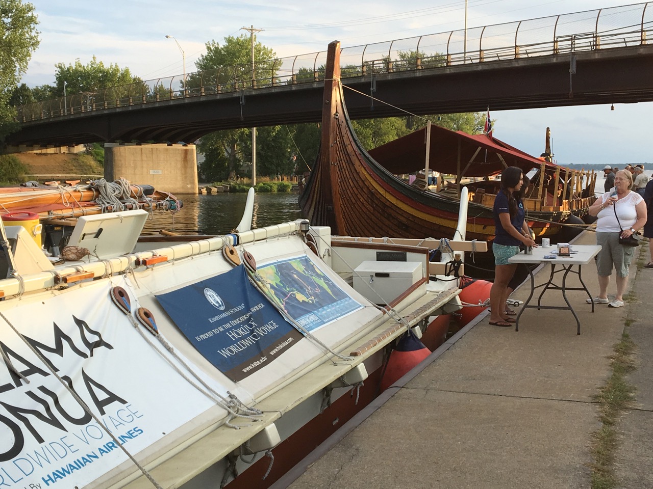

Some traditionalists don’t like the look of a big ole chartplotter mixed up with their bronze and mahogany cockpits, but I noticed that even on Hermione, La Fayette’s replica 18th century French frigate there was a full compliment of digital instruments and chartplotters hidden in a cabinet just behind the helmsman’s wheel on deck.
Likewise on the Draken, a replica Norwegian Viking ship, there was a full complement of modern electronics. Docked alongside it was the Hokulea, a Polynesian catamaran that was on a circumnavigation using only traditional Polynesian navigation techniques.

I understand if you are a Polynesian navigator you spend about 30 years in training and a lot of second-seat time!

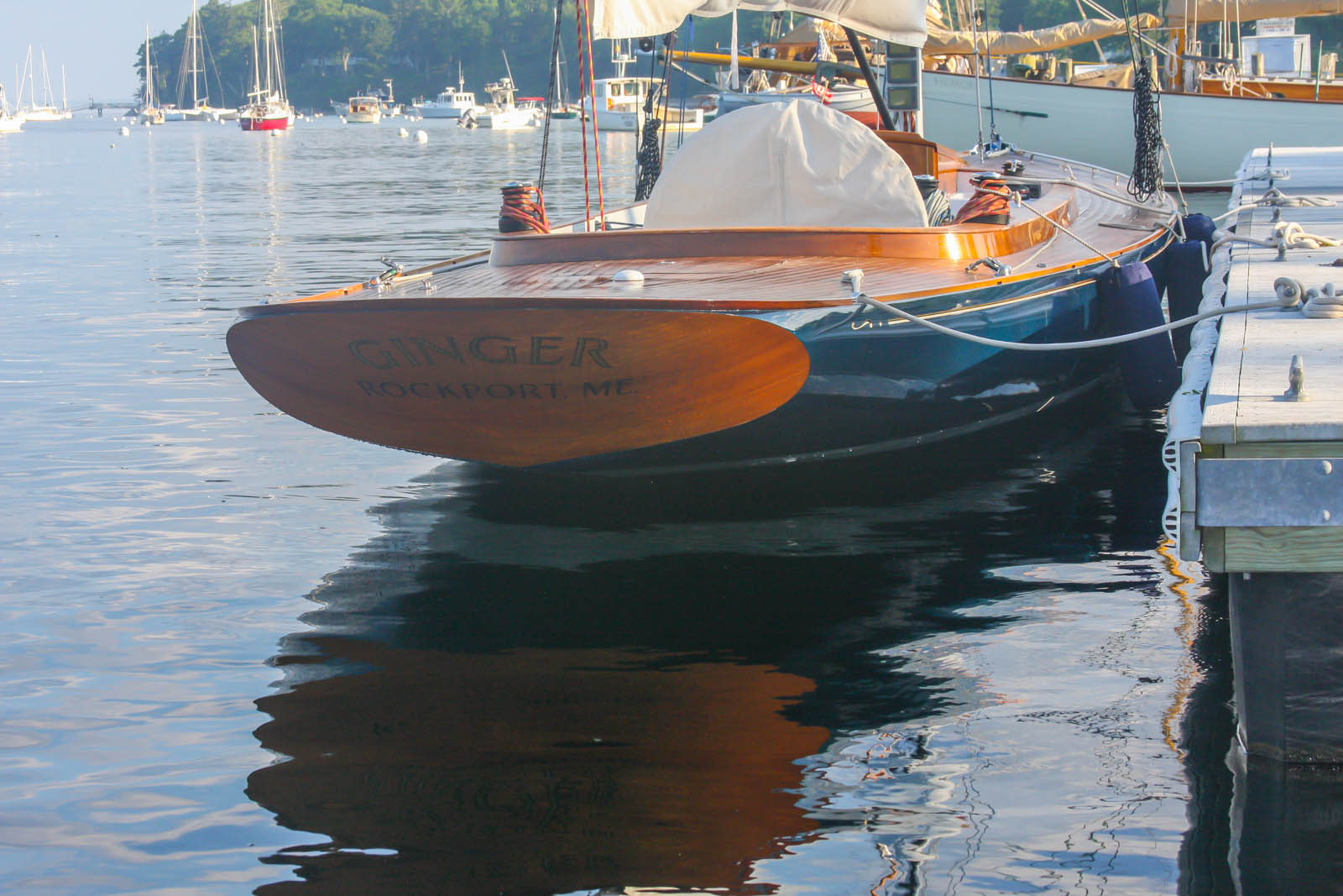

GINGER's keel was designed with a grounding in mind. Pretty boat that looks like fun to sail! This low boat is 50 feet long.
I especially love this part of the blog about the raked keel. It's refreshing to see keel design that fits actual use:
"We custom-formed this keel so the tackle from fishing gear trails smoothly over the keel, hull, rudder and off and away from the boat. We did give up performance by angling this structure. But those few feet per hour were nothing compared to being parked for untold hours unfouling a nasty lobster pot."
I mean come on, let's not design keels solely on that last, "few feet per hour", gained.
