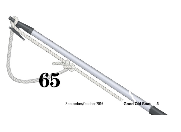

We had an article in the September 2016 Good Old Boat describing exactly this technique with a boathook-- with a good illustration. OK for dropping a loop over a cleat or piling but not for threading it thru an eye. But make the loop big enough and you could drop it over the buoy just to get attached, then thread another line thru the eye.
Good call Jeremy.
I went right to the article in GOB. Sure enough that is it, with the CG references. Yeah it looks like a technique worth learning and practicing, but unfortunately I doubt it would work as I had thought, for these type of mooring balls. I was hoping that this might improve on my current technique... which is quite similar to what Len Ingalls describes up above.

Aug 12, 2014
2,207
Here is a screen capture of the picture from Good Old Boat's preview PDF for that issue. Looks pretty simple and easy to hook a cleat, bollard or piling, but I don't see how you would feed it through a ring.
Maybe reading the article would be more enlightening.
Tend to agree... it won't really do what I thought... the only other idea is that using this method, I might be able to drop a loop over the ring with more of a lasso arrangement... vice the bowline, and at least hold the boat until I can thread the ring.
Still, it is a way to use the boathook that might offer others some insight into issues they have encountered.
Thanks all for the search and comments. Fair winds.
