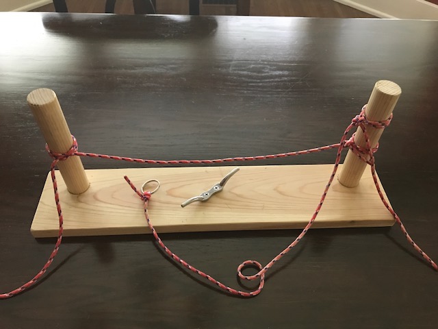

A walk to the end of my dock (about 40 boats) last weekend yielded exactly Zero properly tied cleats. Most were just wads of rope. Granted, this is at an inland lake in Indiana. I would hope at a blue water marina the skills would be a bit better. I like to be competent at the things I do. So, I wanted (and needed) to get good at some usefull boat knot skills. Starting with the basic cleat used at every dock, I found it frustrating to get the knot done properly when needed. A google search for "knot board practice, etc" didnt yield anything that looked like how I needed to tie knots. So I came up with my own, made from scrap I had laying around. I had to buy the 4 1/2" cleat for $1.95. Looks like this
Others I saw were more like a horizontal rod that one could practice various hitches I suppose. But the above design allows for much more combinations of knots. Enjoy.

@CrispyCringle making a practice knott board like that is a great idea. No sailor can know too many knots. Once you become proficient at knot tying you should try your hand at splicing as well.

Nice job, I need to do this for my son and I, maybe even get my daughter working the lines a bit more.

Cool idea! Having an interest, or seeing a new knot on the internet (Thanks Grog!), I often say that I'm going to learn a new knot. Unfortunately, unless I tie the thing a few times, I will never do it in real life. Consequently, I carry around a short length (5 feet?) of old line under the seat of my car so I can try something new. That's a little easier to store than your board, and I can always use it to tie the trunk down if I buy a long piece of wood or something.

i never use or recommend the use of braided line for dock lines. i know they sell braided line labeled as dock line.
it is a very poor choice. i don't agree with any of you photos for that reason.
Well thats it then. Im throwing this in the trash. Knot

Well done! I made a practice board like that for my GF a few years ago. I don't know that she practices on it very often, however. As far as dock lines, I use 3 strand because of the stretch which braided does not have. I think braided is a bit slipperier than 3 strand, also. I think that's what Jon might have been alluding to. The photo was great, however. :thumbup:

the OP wants to demonstrate proper tying up to a dock skills. well, at least use the proper rope.
3 strand nylon rope stretches 40%. braided rope is woven to not stretch at all.
braided is for halyards and sheets. do not want stretch
3 strand for anchors and mooring lines where you want stretch, fenders too
you want to rip your cleat right out of your deck or do you want the rope to stretch. braided line used to tie up a yacht to a dock is a really , really, really bad idea.
I thought that is where you were going but I wasn't sure. Most of the boats I have seen at marinas use the braided dock lines and not the 3 strand and some put rubber snubbers on the line but not all. It is true that there is no stretch as sometime when a boat would sink at the dock the lines would be cut ASAP or the entire dock would be pulled down.
Funny thing though is although I agree with your assessment on the 3 strand none of the commercial vessels I have worked on use stranded lines. I used to jump to the dock while docking a 165 foot multi level ship while the other deckhand threw out a 3-4 inch diameter braided dock line for me to tie off. If the vessel was to stay in port for any duration it would be backed up with steel cable. I wonder why they never wanted strech on such a large vessel? Perhaps they were afraid of line breakage? I never questioned it at the time and it never came up in my master's tests either. Oh well you learn something new everyday.
@CrispyCringle with a 23 foot boat I am sure you'll be ok regardless. you would be hard pressed to tear off a cleat with your outboard running anyway. Still a novel way to practice seamanship which is something we all need practice with.
