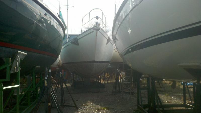

The weather has been nice enough to sail around here. So I drove the 90 miles this morning to visit Ladylove. As you can see she won't be first in the water, squeezed by a new H33 on one side and a nice green ???. And no way to wash and wax come spring, an old Tartan 37 within a foot on port and an ODay 322 to starboard.

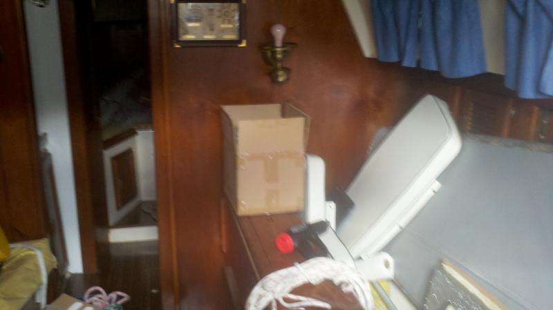

Kind of depressing to see the boat like that, all dirty inside and out. In complete disarray with all those new parts waiting for spring installation. Today I removed the last remnants of any #4 battery cable and even brought the battery switch home. Very concerned about getting three 1/0 cables onto the back of that switch.
