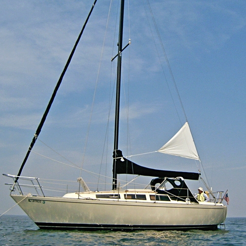

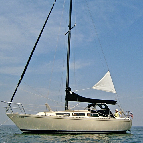

Any 310 owners with in-mast furling figured out how to mount a riding sail?
Apr 8, 2010
2,251
Look at the photo of our boat in the thread I posted the link to. You need only a backstay and the boom, centered and sheeted in tight......
