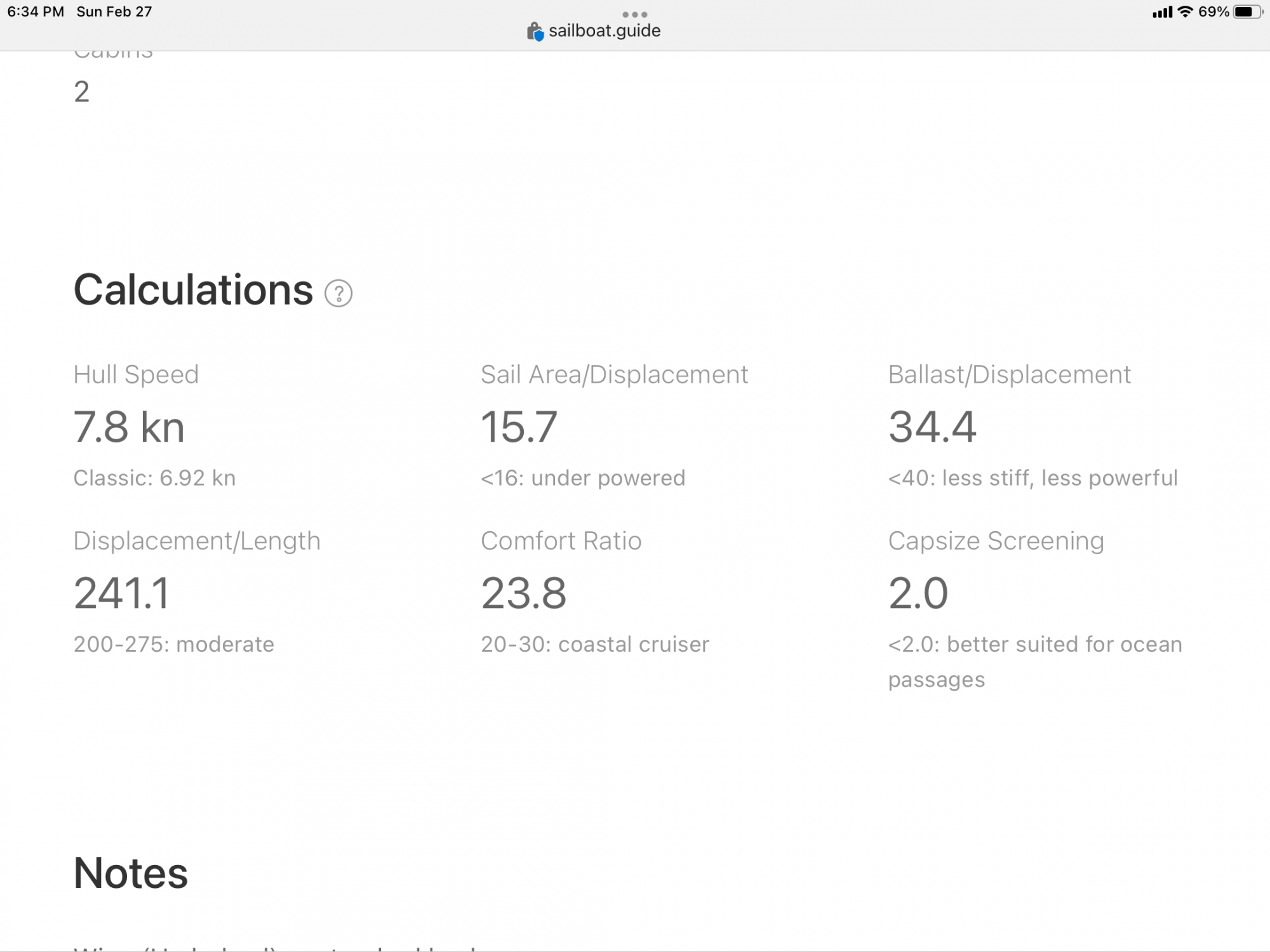

i found this reference for the 322, no idea what the difference is between the calculation and “classic”. I will say that I have (almost) never seen 7.8 knots…unless surfing down a wave.
