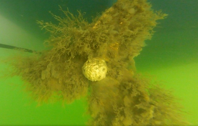

All of these boats are cleaned on a regular basis:
I cleaned this Max Prop two months ago. Here is what it looked like yesterday:
Likes: mytime
