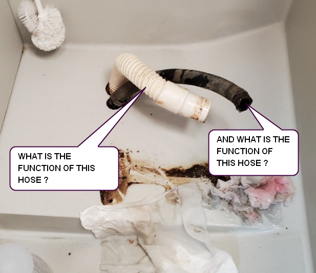

What is the function of :
- the corrugated white hose ?
- the black hose ?
The white hose carried away the waste.
The black hose brought the flush water and was the wrong type for the application.
Regardless, the amount of brown outside the hoses and hidden beneath the floor was pretty disgusting.
I can only pray, for your sake, that @Peggie Hall HeadMistress doesn't see that photo :
The corrugated white hose is probably the last hose on the face of the earth that should be used for transporting sewage. The thin, vinyl corrugations act as traps for solid sewage and the hose would likely start passing sewage gas (H2S) within weeks of installation.

My boat had quite bad head odors coming from the compartment with the holding tank when I bought it. The hoses were old but there was also an anti siphon loop that was not odor safe between the head and the tank. I'm pretty sure that was the main source of the smell. I replaced the hoses and sprayed PuraAyr into the compartment several times over the season. After several months the smell went away.

My experience is if the water used for flushing the toilet is salt or lake water it is loaded with natures little creatures that love human waste and contribute to the unpleasant head smell. I only use fresh water to flush. Some people actually plumb a fresh water line to the flushing connection. I do not, I just use a pot of water from the sink. I do not have any unpleasant odors in my head and have been using this method for over ten years. I did have to replace all the head plumbing hoses and did this ten years ago using the recommended sanitation hose identified earlier in the post. I have a 1996 37.5.

Scott, if your hoses are 10 years old, it's time to replace 'em again. 10 years is the average working life of any hose because rubber and plastics dry out over time, becoming hard, brittle and prone to cracking and splitting--not good in any system, but the last thing you want to happen in a sanitation system. Raritan SaniFlex has a 10 warranty and has the added advantage of being so flexible that it can be bent almost as tight as a hairpin without kinking, making most hose replacement jobs a LOT easier. Defender has it for about $10/ft.
There's an easier way to supply your toilet with fresh water SAFELY (no sea water toilet should ever be connected to a fresh water line!) than using a pot of water: tee the toilet intake line into the head sink drain line. Keep the the thru-hull closed except when using the sink. To flush, fill the sink with clean water (never use gray water, soap scum etc will mess up the toilet pump)...because the thru-hull is closed, the toilet will pull the water out of the sink.
