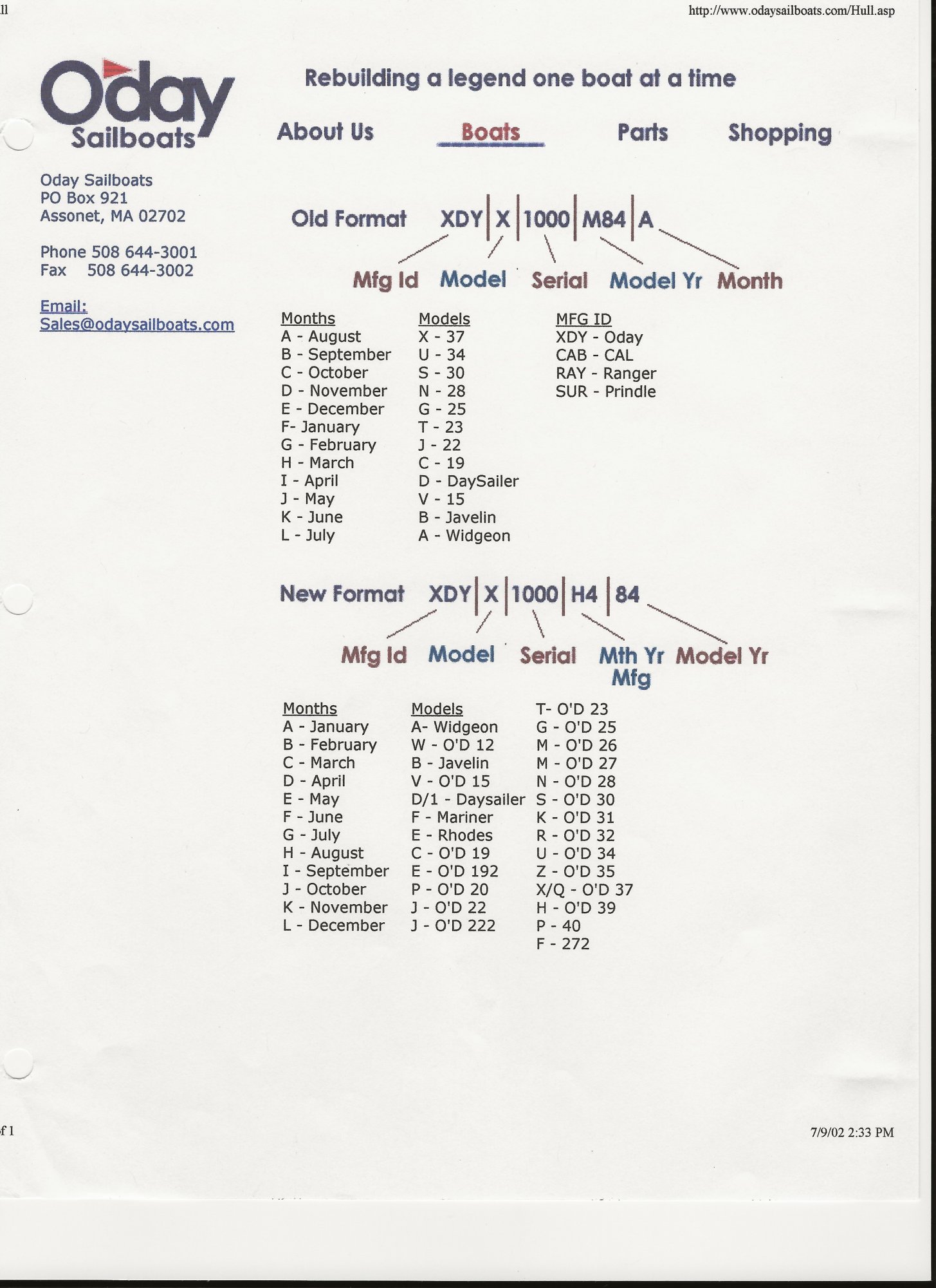

XDY - It’s an O’day
N - An O’Day specific model name distinguisher, for an O’day 28 in this case.
0659 - Hull number 659 within that model.
The first 86 - Could this be “B6”? If so it was built in the second month (month B) of 1986.
The second 86 - Model year 1986.
Credit to O'Day Hull Number Reference Guide for having a handy decoder.

From the O'Day Mariner Web site (Hull ID Help - Mariner Class Association).
"All boats manufactured or imported on or after November 1, 1972 must bear a Hull Identification Number (HIN)."
It was standard practice before '72 for many manufacturers to have a HIN, but there were variations in its form. If you know when your boat was built, it will be easier to decipher your HIN,
"Example #1: XDYF26040373
In this example XDY is the designation given to the O'Day company and F means it's a Mariner. 2604 is the sail number, the 0373 means the boat was built in March 1973."
Example #2:

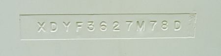

"Here is an actual molded in serial from a 1978 boat.
Code XDY (O'Day), F (Mariner), 3627 (Sail Number), M (Spacer), 78 (Year) D (Nov. built)"
'M' = space. ¿Porque?
Key to Month of Model Year - Pre 1984.
AUGAFEBG
SEPBMARH
OCTCAPRI
NOVDMAYJ
DECEJUNK
JANFJULL
This chart seems illogical to me. Why randomize the order?
"Starting August 1, 1984 the letter designation for the month built next to the year built starts with A=Jan, B=Feb. etc."
"Boats manufactured or imported on or after August 1, 1984, also have a duplicate secondary HIN affixed somewhere on an unexposed location inside the boat or beneath a fitting or item of hardware. The purpose is to help authorities identify your boat if a thief or vandals remove or damage the primary HIN on the transom. It is illegal for anyone (manufacturer, dealer, distributor, or owner) to alter or remove a HIN without the express written authorization of the Commandant, U.S. Coast Guard."
AUGAFEBG
SEPBMARH
OCTCAPRI
NOVDMAYJ
DECEJUNK
JANFJULL
Not to throw a monkey wrench into the issue, but it's possible your boat is a '68 built in September at a factory with the designation 6. O'Day had, at one time, several factories. I remember reading about the particular factory designation having made it into the HIN, but I can't find confirmation of that memory. The example above, of the ...M78D HIN is an unusual example where the month of manufacture is printed after the year. Or, the '8' in your number really is an '8' and 8686 means factory designation 8 in 1968 in June.
-Will (Dragonfly)
I don't understand what you mean by "randomize the order" referring to the month code, MODEL YEAR ran from August to July, so the first, say 1982 model of a boat was at the time, built in August 1981, the last in July 1982. That is why the code letters are that way.
The original poster has a 1986 Model boat, can't be a 1968 because the 12-Digit HIN was not used until November 1972. Prior to that O'DAY used 2 Numbers to ID a boat, a HULL# and a CLASS#, Hull# referred to total O'DAY production, Class# referred to how many of that class. For instance, my 1970 O'DAY WIDGEON was Hull# 22698 Class# 1791, that means she was the 22698th boat built by or for O'DAY, and the 1791st Widgeon. My 1979 DS II has the HIN XDY10101M79E-D, which translates as XDY = O'DAY, 10201 = Class#, M79= 1979 Model Year, E = December (in this case, Dec 1978). The D = Day Sailer, it really should immeditely follow the XDY, but unfortunately, that wouldn't fit! <GRIN!> the USCG required HIN format had no provision for Class/Hull #s greater than 9999, so O'DAY had to add the Model Designation to the end with a dash. OOPS!
