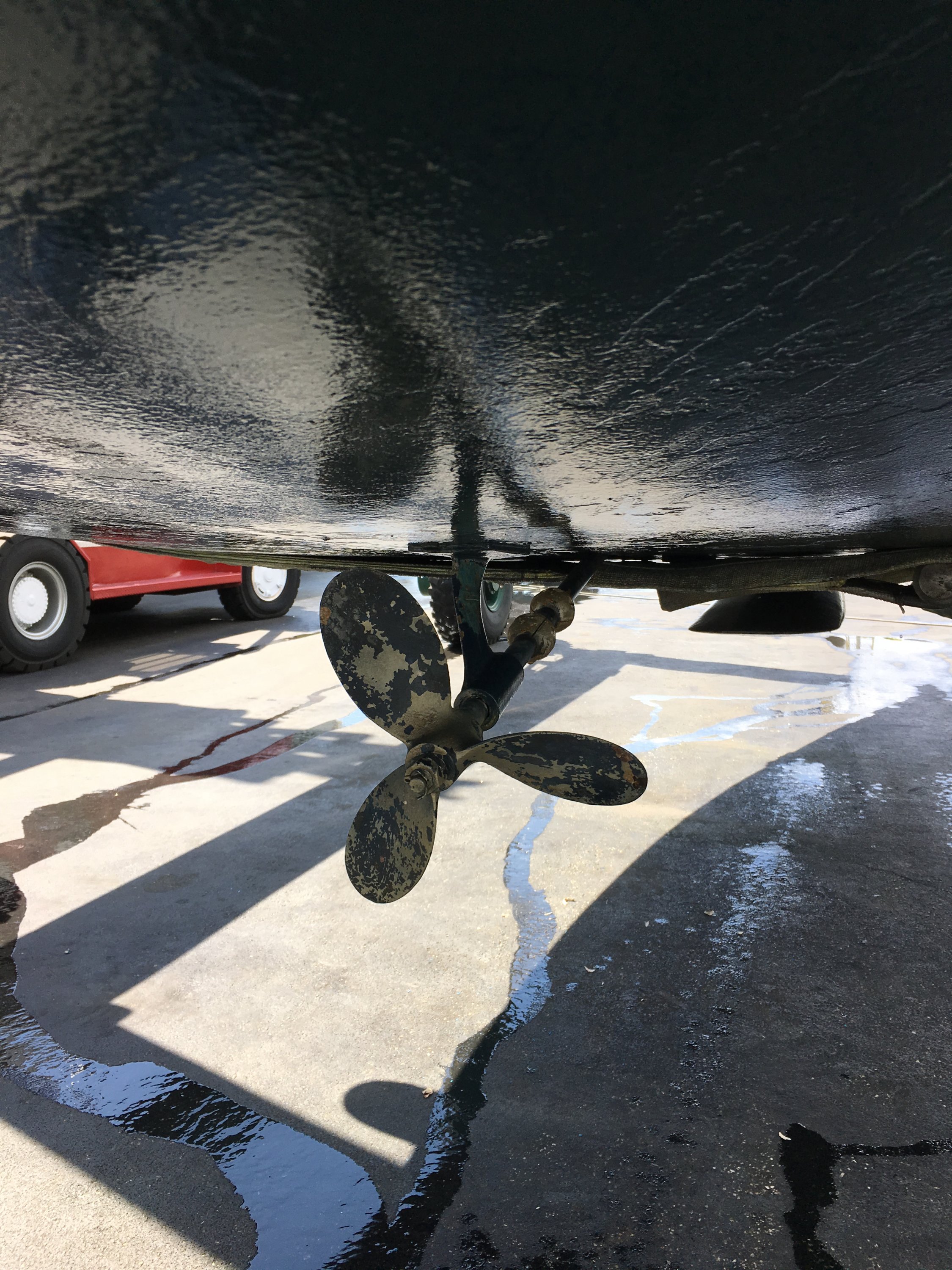

I recently hauled my '84 Hunter 34 to do a bottom job. I did it myself. Sanded. painted. Buffed. Replaced zincs. The yard put the boat back in the water when I was not there. The first time I took it out it pulled to the left in a big way when motoring. In neutral it goes straight when coasting. There was no hint of this before. What could have happened? I dove the boat and could not see anything wrong. It was a quick look so I did not expect to. What can cause this? Any ideas?

I would suspect the launch crew has knocked your prop out of alignment. Chief

Is there any way that the rudder was over driven so what you used to have as center is no longer?
Edit: well probably not as it coasts straight. More likely what Chief RA said. Any vibration at wide open throttle?
Maybe they bent the strut.

Have you operated the boat with a clean prop and bottom before?
Most sailboats do what you are describing because the prop and strut are slightly offset to facilitate removing the shaft without removing the rudder.

I would check the prop and strut to see if any strap was placed on that. It happens at yards.
How? By bending the shaft? Seems like there'd be other noticable issues besides a pull to one side or other. Like vibration.

fstbttms: Note that there is no indicator of whether it vibrates or not. If the stern lift strap slips, guess where it ends up. Chief

My point is that the only way that the prop is "out of alignment" is if the shaft was bent. If the shaft was bent, it seems likely there'd be other, very noticable indicators that this was the case. I don't believe the strut could be bent without it pulling out of the hull.

Had a similar occurrence once but never figured out the cause. Our diver had just cleaned the bottom a few days earlier and I asked if perhaps the prop had not been cleaned. The diver indicated that he had indeed cleaned the prop and that he had not noticed anything out of the ordinary. Since in neutral or under sail the boat tracked good I surmised the problem was not with the rudder but something with the engine drive train. I also felt the engine was lacking power and smoking a little which reinforced the theory of a fouled prop. I went ahead and replaced the fuel filters, adjusted the valves lash and changed the engine oil. Next weekend we went out and the problem was gone. Don't know if it was an engine torque issue or if the diver came back during the week to correct something he had done. Check the sacrificial anode and the balance on the prop.

There may actually be some vibration that was not there before. It was the first thing my wife noticed. This weekend I may dive the boat with the engine running and in gear to see if there is any wobble. Fstbttms: Is that safe or completely crazy?
I've done it many times. Just be well clear of the prop and off to one side.

Is there a chance some of the steering linkage slipped a bit? On my B323 I centered the wheel and made adjustments until the quadrant was also centered. Then, I took the boat out on auto pilot to make sure it tracted straight.
UPDATE to add... if it does not go straight, adjust the cables to move the rudder as needed.

Take my word for it strut can be bent without pulling it out of the hull AND without bending the shaft. Don't ask how I know this....
