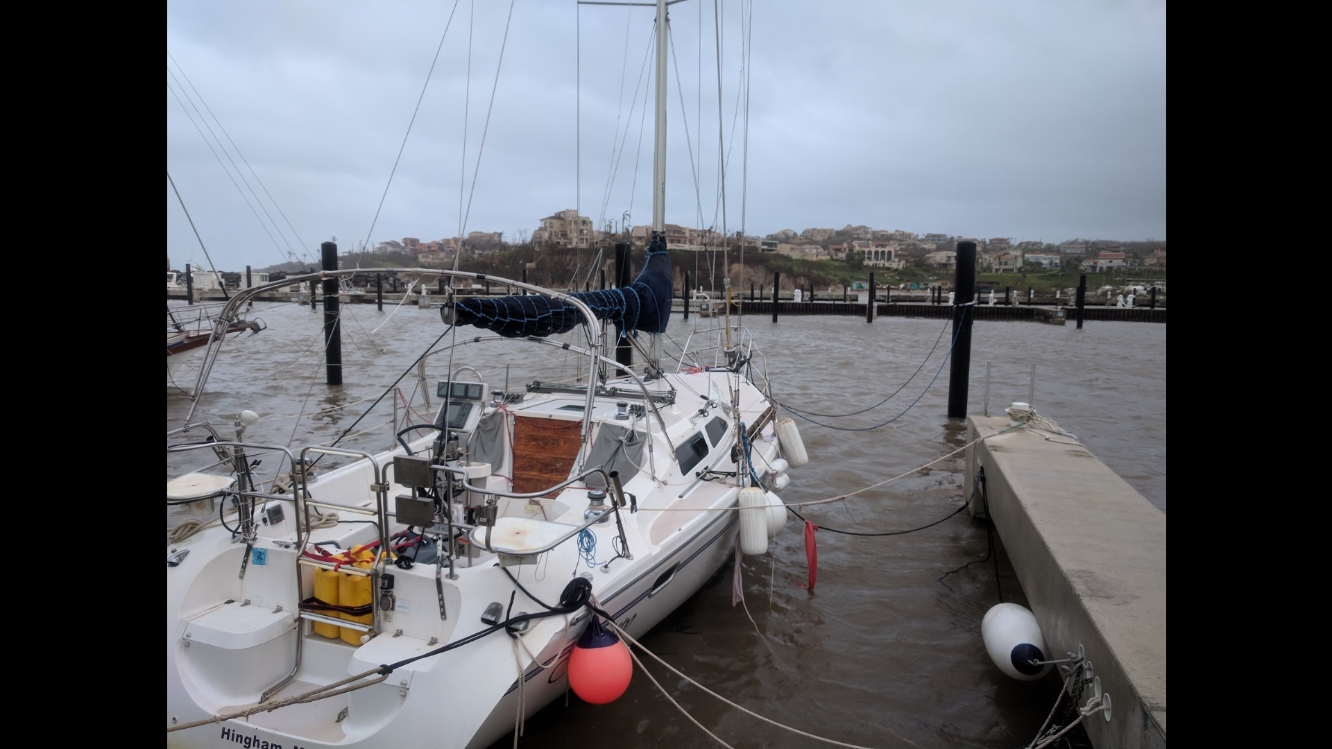

I’m not sure how long ;)sail ties (or any ties) would work against a 100 + mph wind.
I don't know about using sail ties but here is my boat with the mainsail lashed to the boom. The sail was lashed with 1/2-inch Sta-Set, I used my headsail sheets. This picture was taken in southeast Puerto Rico just after the eyewall of Maria passed as a category 5. Winds were estimates at 175 mph.

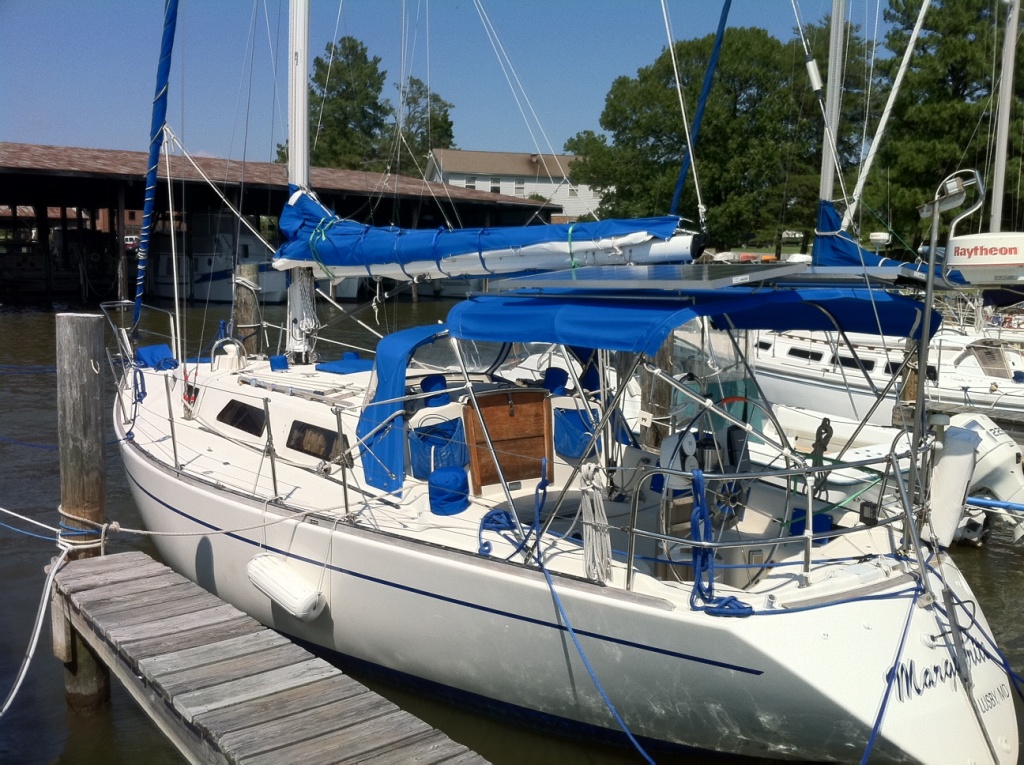

Wave goodby to your Bimini or dodger if not removed.
The recent tropical depression that visited the NE states almost 3 weeks ago had a lot of people on the move. Too many boats were in the water for the few local boat haulers to make a dent into. It became an exercise in securing. Most Genoa were dropped, and mains got helical wraps...Bimini and dodgers were also struck... well not all. I acquired enough new lobster trap netting to cover my dodger & Bimini along with an identical sister ship. Lines were woven and bolstered with wire ties through the netting. The lines were the secured to cleats. The net allowed wind to pass through and prevented the uplifting that would have carried the Bimini away. About an hour to install and 10-15 minutes to undo.
