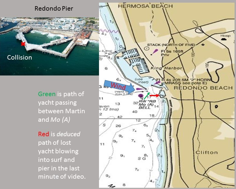

Thanks Kings, that chart section really helps. So in the classic definition the Redondo Beach Pier WAS the lee shore. You want your approach to King Harbor to be powered-up and controlled to take you clear of a lee shore. Yet they stumbled in downwind, mainsail down, wrapped jib, no engine. I don't think a typical stern outboard would have saved them by the time the long vid begins. I see two scenarios that would have saved them. Anyone want to guess?
Well, they did not die; so, save the boat I presume? The skipper should have called for assistance (tow) immediately the boat lost her power to maneuver against the lee shore. But-- did he have a hand-held VHF and was there even time for that (a rescue)? The best alternative to what happened would have been, IMHO, to attempt to gybe and go ashore on the sand beach to the south of the pier. But at that time, you'd have to accept that the boat would probably be lost and you still might be tumbled in the surf. Although it could get another minute or two to await a hoped for rescue. Before that, however, I'd pitch the anchor if it was accessible.

It's not evident what happened prior to the boat losing the power of her jib. If you look at the deduced path, it's likely the boat was doomed when she blew much past Mo (A) w/o making the turn; no way the boat with a crippled jib and makeshift sheeting would be able to come up sufficiently at that point. I think what we saw was likely "unfixable" by that time.
But why could they not have wore ship, a few minutes earlier, and headed back out on a beam reach? That is where the mistake was made. They let themselves run out of room.

The events leading up to the beginning of the video would certainly give us a better idea of what could have been done to avoid the loss of the boat. All we get to see is a vessel out of control for approximately 3 minutes in rough seas, onshore wind that was estimated at 30+ knots, mainsail out of track and out of control, and a jib that is partially wrapped with no control, with a lee shore (pier) approaching fast. Without the main to power them to weather , further offshore , they were doomed. With only the jib partially available causing a lee helm, combined with stiff onshore winds and seas pushing them to shore, the outcome was inevitable. As King stated, even if they had jibed earlier, they would have landed on the beach on the other side of the pier. That would have been safer than crashing into the pier. The only way out, in my opinion, was to drop anchor immediately and to sort things out with the sails and rigging or possibly calling for help while anchored. In the 3 minutes that we saw, I don't think there was enough time for the harbor patrol to get on scene and get a line secured. Real scary stuff; truly amazing that everyone escaped unharmed. Best decision that they made was to have pfd's on. As others mentioned, that's a difficult harbor approach under the given conditions without full sails or lots of horsepower.

Yeah, the boat could handle the wind, but not the breaking wave. The water shoals up to 6 feet where they rolled. If they had lost the ability to fly the main sail they then simultaneously lost the ability to make their port - it was a close reach approach and they couldn't make that on their jib. With their main lost their options were to Gybe back out, stay beam reach and call for a tow. The decision to not stay out, to wear ship as Thinwater says, was huge. They stopped sailing the boat. I suspect that unreasoning panic had swept the crew. Broken gear and the wind howling in your ears.
In the final moments of their control you see them turning dead down with only a partial jib. With CE forward they were locked into lee helm and the inevitable loss of control. That was where their last option slipped away. They were in 10 feet of water, throw the anchor. The recovery boats were on scene within 5 minutes.
