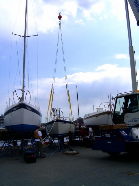

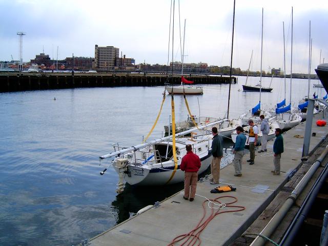

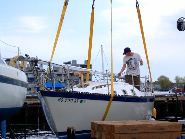

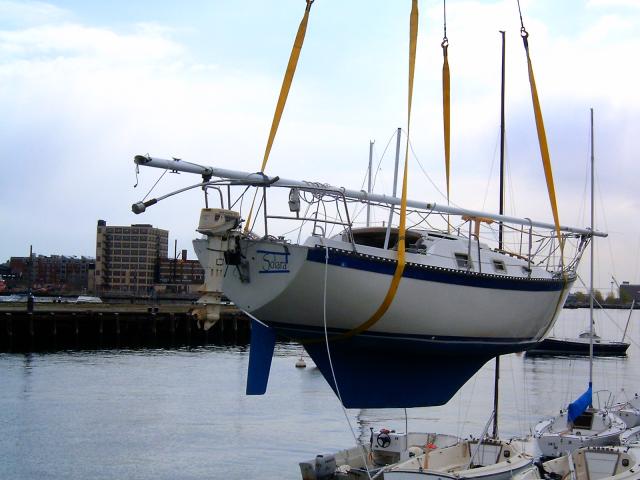

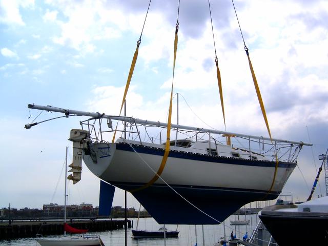

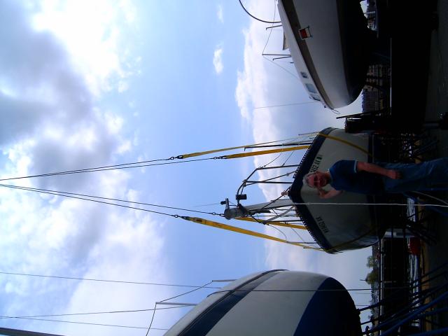

Visual aids
Photos of Solara, my old L25 being launched with straps from a crane. Also, why don't you hire a rigger for an hour or two to help you work out the details and to point out exactly what to buy. In the last photo you can see that they apparently used webbing extended by steel cables hooked onto the cranes hook. I don't know how much height you have to work with though.
