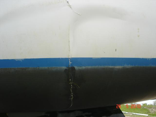

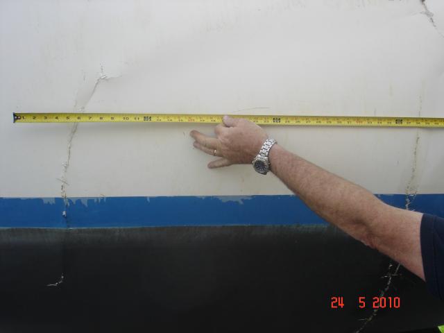

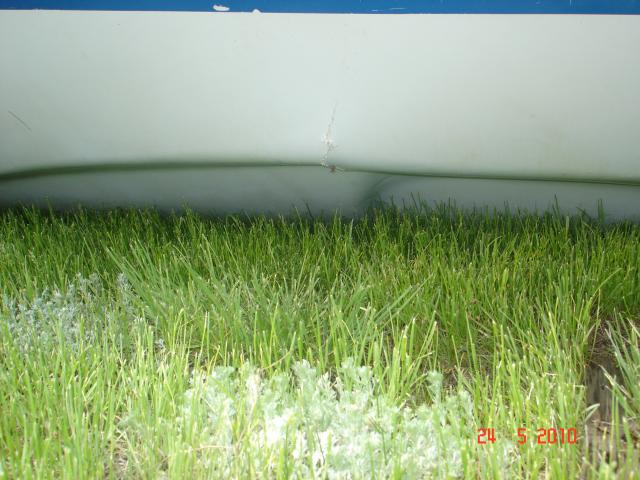

Well here's a couple of pictures. We got down to the boat about noon and had a crane truck meet us there. Before we started the lift we got a few more pictures. I'm not sure if it will show up. It seems like to me there is quite a bit of damage. There are at least 2 ribs involved, the nav station on the inside has been pushed away from the wall. The fiberglass is cracked/broken almost from the keel to the rubrail. Will be calling the insurance co. in the morning.
Not sure what else I can tell you at the moment. It was just bad luck that I had moved the boat last week to step the mast and we had sooo much rain and wind. It would appear that the one corner of the cradle was in a softer area of the lot and the wind pushing from the other side didn't help.:cry:

Don:
This is sure a lot more damage that I would have imagined. I would not be too suprised if they just total the boat. These boats are worth about $20-25k here in the states.

That does not look like good news. You have about 15 square feet of broken fiberglass in that dent. Repairing it will involve stripping the interior out to a bare hull on the port side. If you had no insurance and good skills you could repair it for less than 3 thousand dollars plus an awful lot of your labor. But on a 25 year old boat I don't expect the insurance company to repair it.
