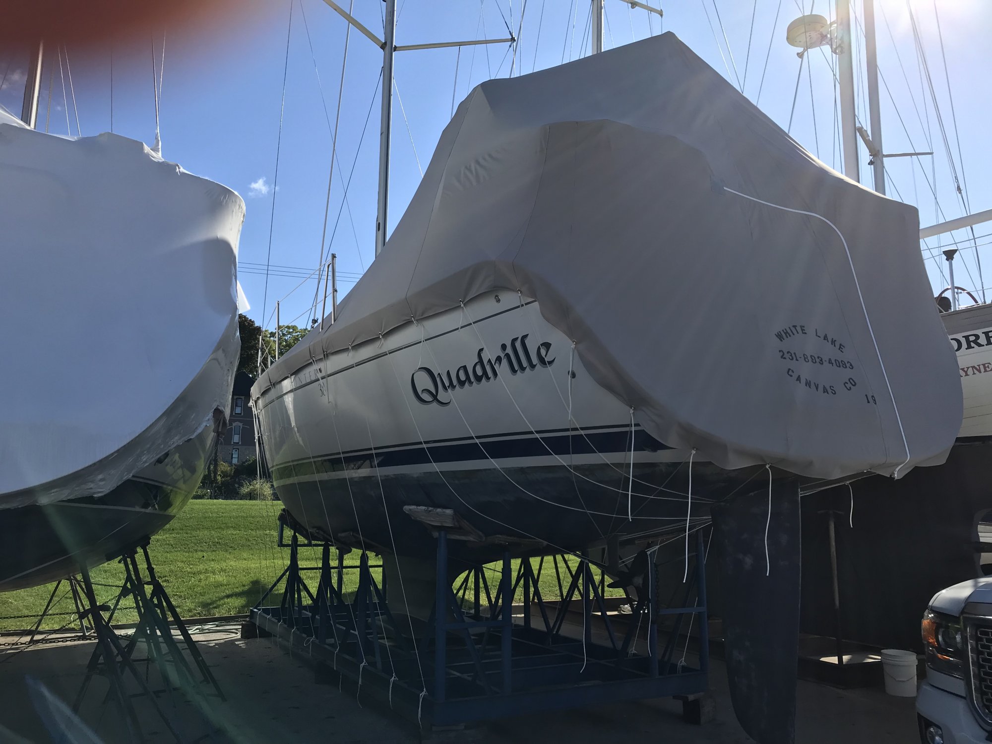

My boat has a canvas cover for the winter and I still get water in the bilge. I realized last year that the canvas has lost all of it's water repellant properties over the 11 or 12 years that I've had it. I used to think that water must trickle in from the deck stepped mast base with it's hole for the wiring (I had that problem for a while) but I sealed that issue and it is never an issue in the summer rains anymore. I don't see how dripping water from the canvas makes it into the boat. My conclusion is that all of the water must be a collection of condensation.
Lately, since I've been at Mariners, they put antifreeze in the bilge and then I promptly mop it out because I can't stand all that sticky stuff in the bilge. But then I still get a few inches of water that freezes on and off. We don't have a solid freeze from December thru March as others have. Most of the time that I go to the boat in the winter there is sometimes ice and some melting water and I just clean it out. But I also know that my bilge pump has been submerged and frozen multiple times. I think a bilge is like an ice tray. The water freezes but there is no pressure. Ice is relatively plastic. Where there is space to expand, that's where it expands. It only causes damage in places like pipes where the water is under pressure and the ice has no room for expansion. Ice will split a copper pipe or a steel engine block in a heartbeat, yet you can fill a flimsy metal or plastic ice tray over and over again and there is no damage.
