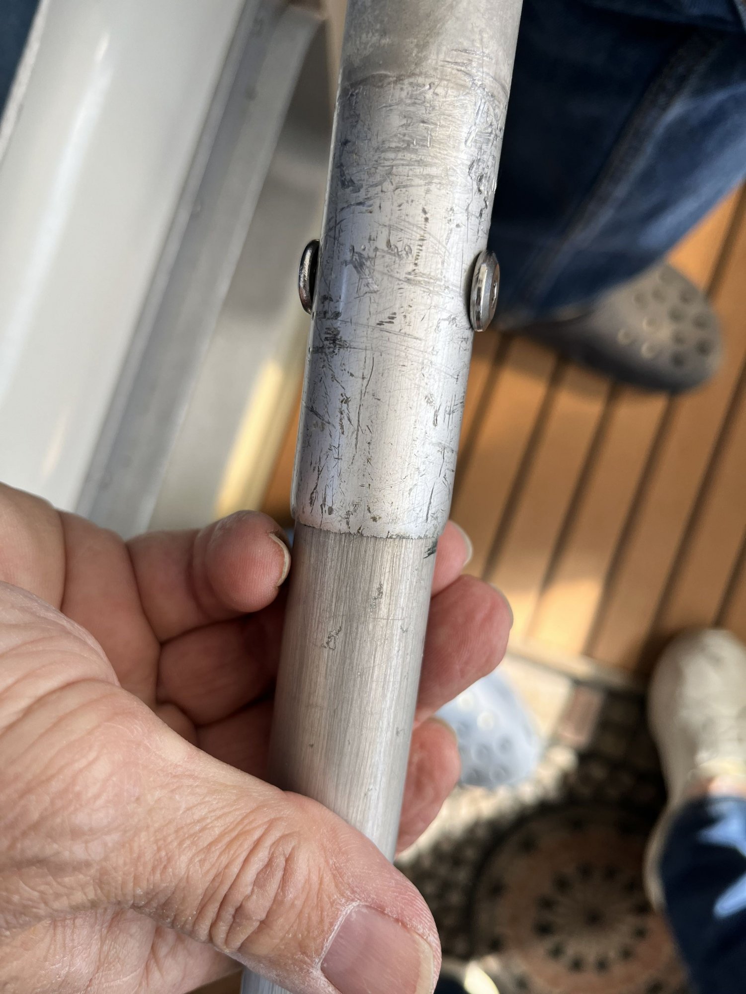

Hi all,
Has anyone ever fixed an adjustable boat hook that won’t hold an intermediate length?
Mar 26, 2011
4,050
Corsair F-24 MK I Deale, MD
Hi all,
a. I have found the Davis hooks to be most useful (very light, durable, most usable hook).
b. Yes, the lock will wear over time. But normally the problem is salt buildup inside. Try a light acid (CLR or similar) wash while fully extended, and then work it back and forth, then let it rest, then rinse. If I was smart this would be part of the spring cleaning list!

I have…and as Thinwater stated, clean it.
I have one boat hook that does that every season. I am old school, though.
I unscrew the two pieces, wipe down the plastic and inside the tube with Pure White Vinegar. (89 Cents/guart)
Put it back together and like magic it holds again.
Try it, its nature’s miracle cleaner. It removes the film of grease and leaves behind a clean surface.
You can even pour some down the tube, block both ends, shake vigorously and remove. That cleans the entire tube.
I know it sounds like TV commercial but it works…..And if you act now we’ll include our super absorbent drying towel.
Try it.

I fixed the boat hook with a shoulder bolt, (AKA many names for the bolt).
I now have a 12 foot boat hook for $2.00.
