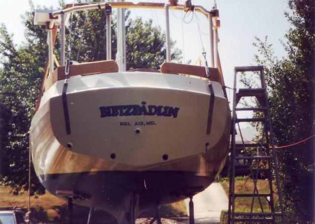

On my boat I had small drains and they could be covered by a single leaf each. I used a hole saw and cut through the aft bulkhead and then through the transom and glassed in a 2 inch pvc pipe that has about 3 inches of drop in the length. I glassed the full length and also glassed a strut under it so that if someone(me) stepped on it there was no chance of it breaking. There is a serviceable anti-back-flow valve in the line.

Polyester resin bonds to pvc so I just brought it flush on both ends and faired the glass into the bulkhead and transom. The back flow valves are stock for sewage systems and can be found in the plumbing supply stores .I haven't ever seen them in the big box stores.

That is a great idea, Ross.. Have you a picture of the installation? I don't remember what the aft end of that boat looks like..
I found a picture. The two large holes are the drains and the smaller hole just below "Bel Air" is the exhaust.
