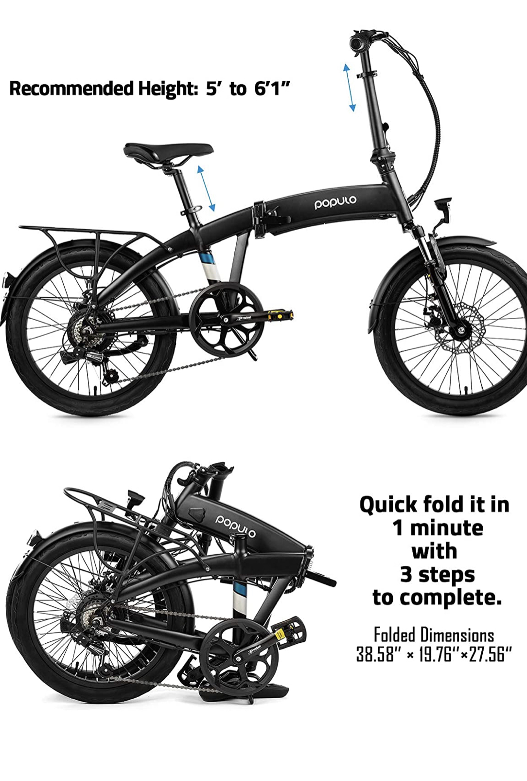

Such bikes are great in the flat lands.
When you gunkhole in areas that have hills then the good choice is an electric bike.
Better yet a foldable electric bike.
