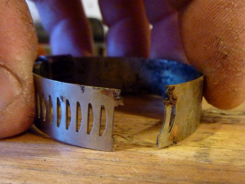

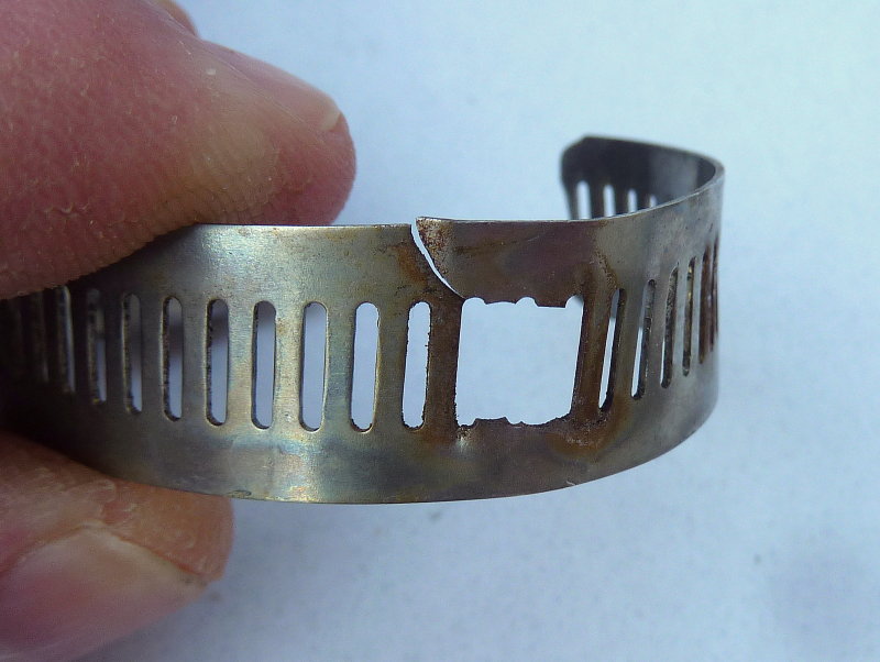

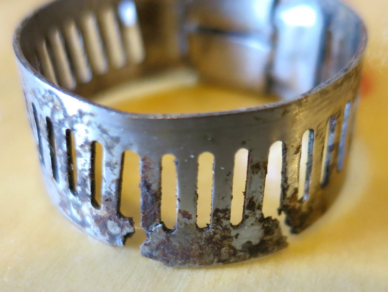

Likely also had crappy, substandard perforated hose clamps.....
This one I found yesterday at about 2:00 PM on a 30 foot lobster boat. It was the ONLY hose clamp...

I guess someone took the "unsinkable" feature literally when deciding whether to fit a valve or not. Have had thru-hulls with no valves but they require a proper hose with double clamps at each end and frequent inspections. Keep wooden plugs attached with a fishing line. Beware of the backside of clamps as they may look new on one side and be rusted and broken on the other.

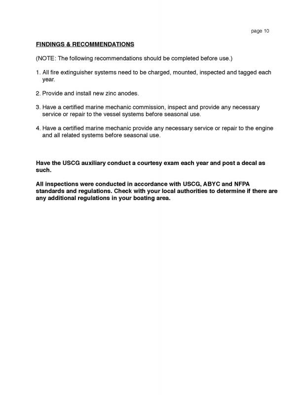

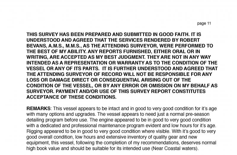

Here are a couple of pages from the most recent survey I had. If you combine the "design defects" out by insurance companies with the "good faith" language in the survey portion I attached (Smitty Survey 2) you could end up with a sunken boat that no one will pay you for even though you are carrying insurance.
Granted that would be kind of a perfect storm with the surveyor missing something that could be deemed a "design defect". But as a hypothetical, let's say the surveyor noticed that the propane locker drain dipped low on it's vent tube creating a low point that could fill with water and block flow. But instead of putting it in the survey he tries to be a nice guy and just tells the owner about it. Well that could lead to one of these perfect storms if the owner didn't fix it.
And on the insurance company looking for outs, look at recommendations No. 3 & 4 (on Smitty Survey 1). The surveyor who did this is someone that works extensively in my area doing insurance and refinancing surveys. I asked him to remove the "certified marine mechanic" lines and he said no, it's part of his standard language and goes into every survey report based on advice from a lawyer. Would this give insurance companies an out to deny coverage to anyone who does their own work? I have never had a professional do any of the work since I have owned this boat (last 4 years). I have done a fairly extensive list of upgrades and repairs and I would like to think I do a good quality work. He even made a comment in the report "the engine appeared to be in good to very good condition with a dedicated and professional maintenance program evident". That's all my work he's talking about. The previous owner never even changed the impeller in 10 years of owning the boat. But does the "certified marine mechanic" recommendations give them another out?

The reference to the "Certified" mechanic is simply a protection for the surveyor making the recommendation. He wouldn't say, "have your incompetent buddy Richard" do the commissioning because that would be derelict. It also provides a recommendation that you hire a competent tradesman who will come with professional liability insurance that can be tapped in lieu of your own if there is a loss.
If you are qualified to do this work you can certainly do so and still retain insurance coverage. Just be aware that if there is a loss, they can inspect the cause, and if it is your work/your fault, it would jeopardize your claim. Basic risk management decision here.
