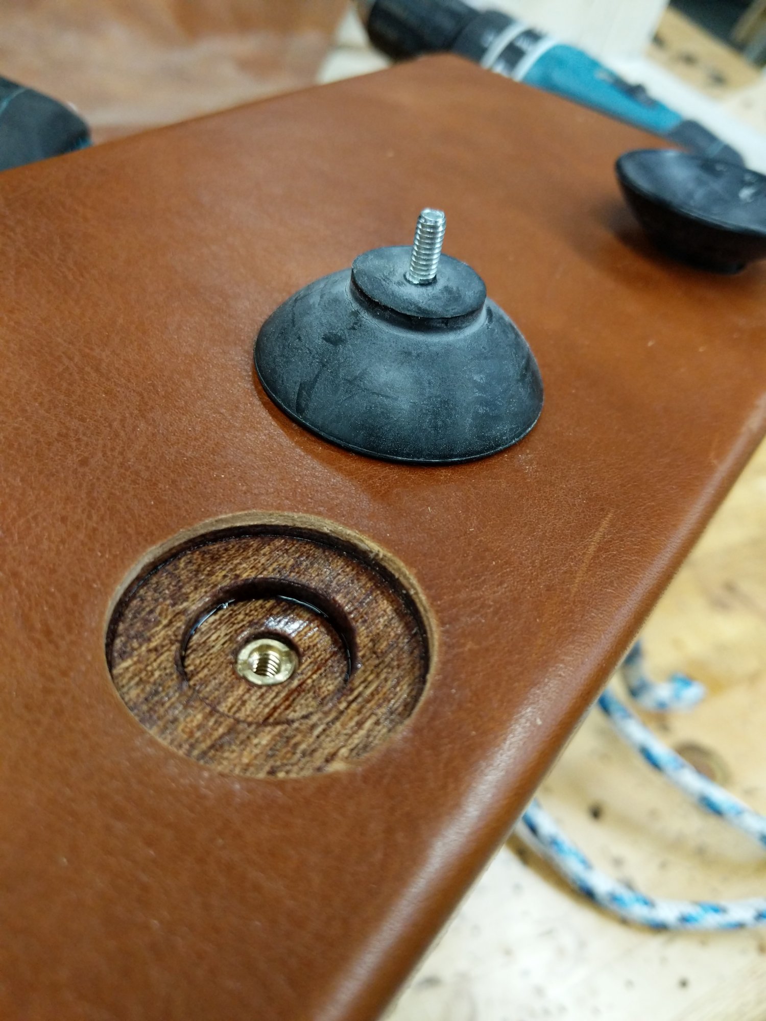

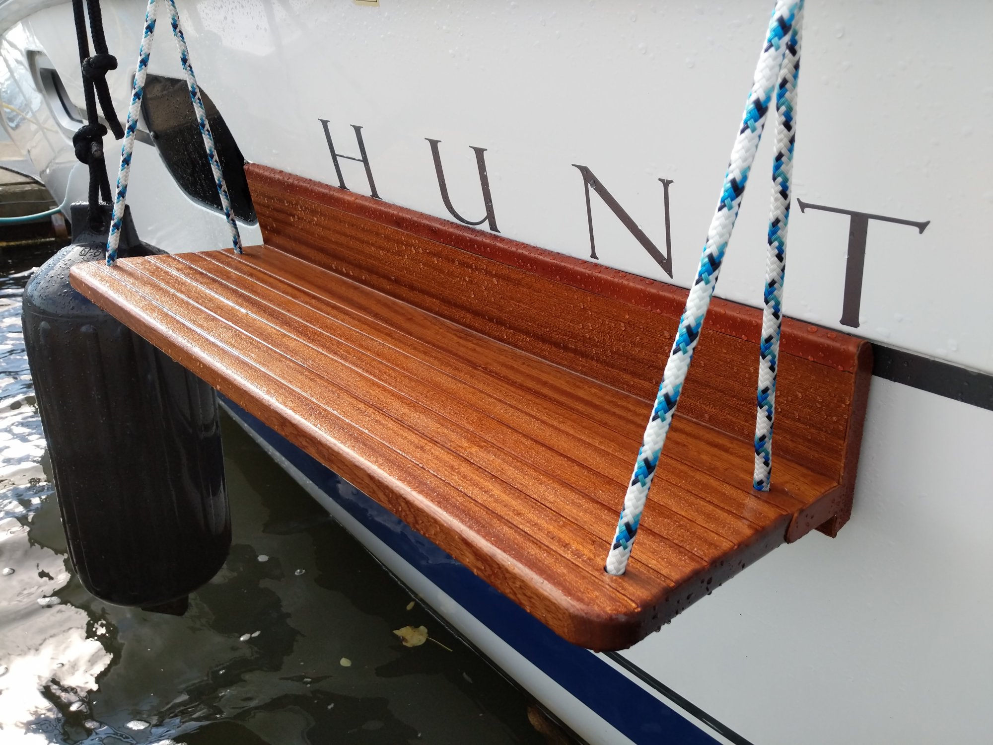

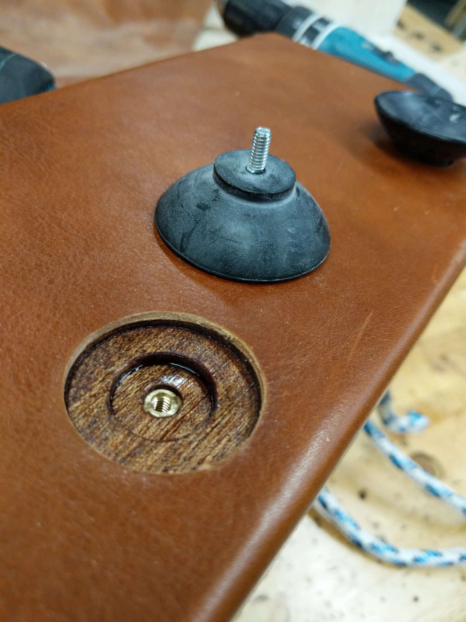

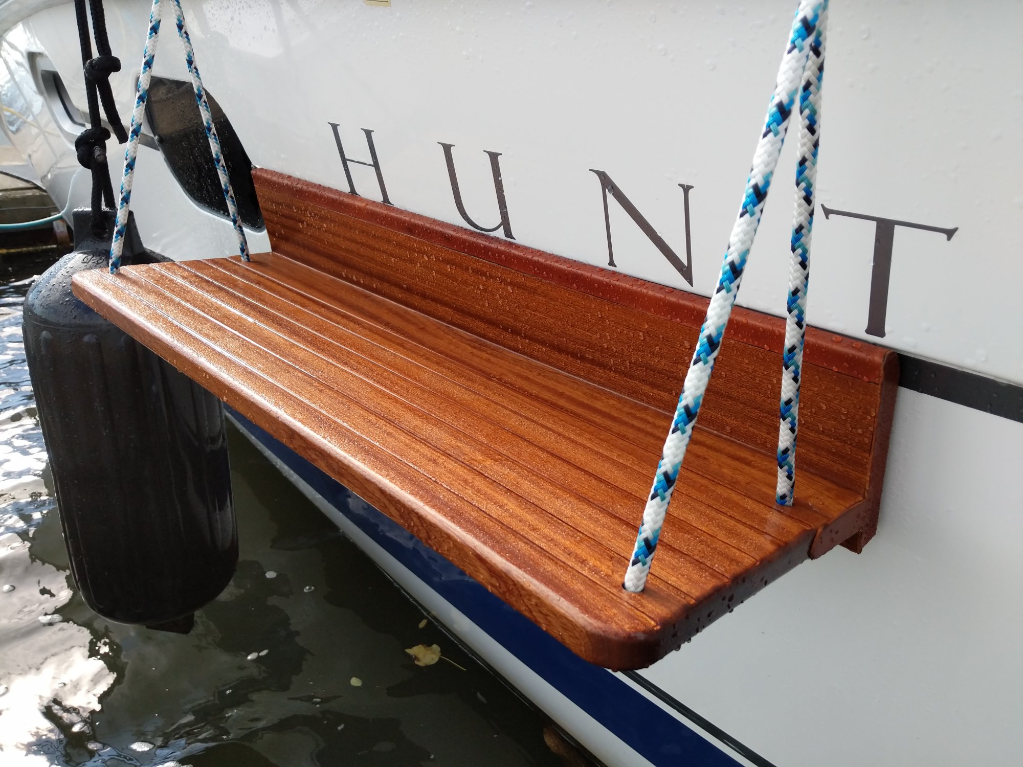

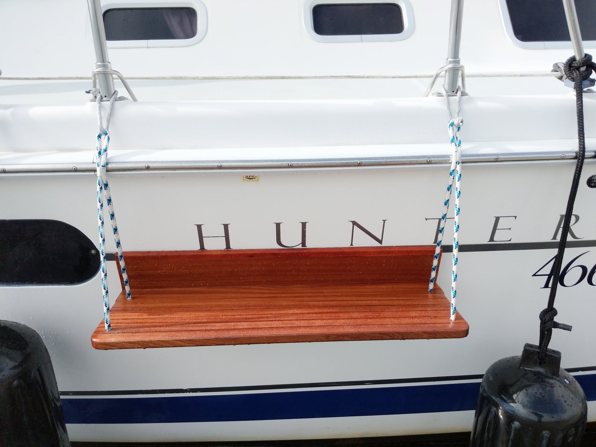

I purchased a Hunter 466 this spring and it came with a dilapidated rigid step that was made of plywood, was difficult to switch sides when needed, flaked paint off everywhere, and was nearly impossible to stow. After seeing Rich Stidger's step that he made a while back, I went to work and came up with a design that the admiral was happy with. I thought it would be straightforward to make... It wasn't. We designed it based off the design of the other steps inside the boat. The parts that touch the boat were covered with leather left over from the hide we bought for covering our steering wheel. Worked out the angles, put it all together, applied a spar varnish to it, and it didn't work! The toerail on the 466 extends out and pushed it out too far from the hull and it hung free and unstable until you put weight on it. After scratching my head for a while, a neighbor suggested suction cups. I THEN made a plywood mock up to make sure it would work. I recessed them into the back and they worked perfectly! Super stable, easy to bring in and switch sides (made some dynema soft shackles). This was a really fun project that took far longer than I thought, but hey, all projects take longer than my optimistic estimates. We went with 5/4 sapelle mahogany for the wood, contact cement to adhere the leather, "TreadTex" in the varnish for grip.
