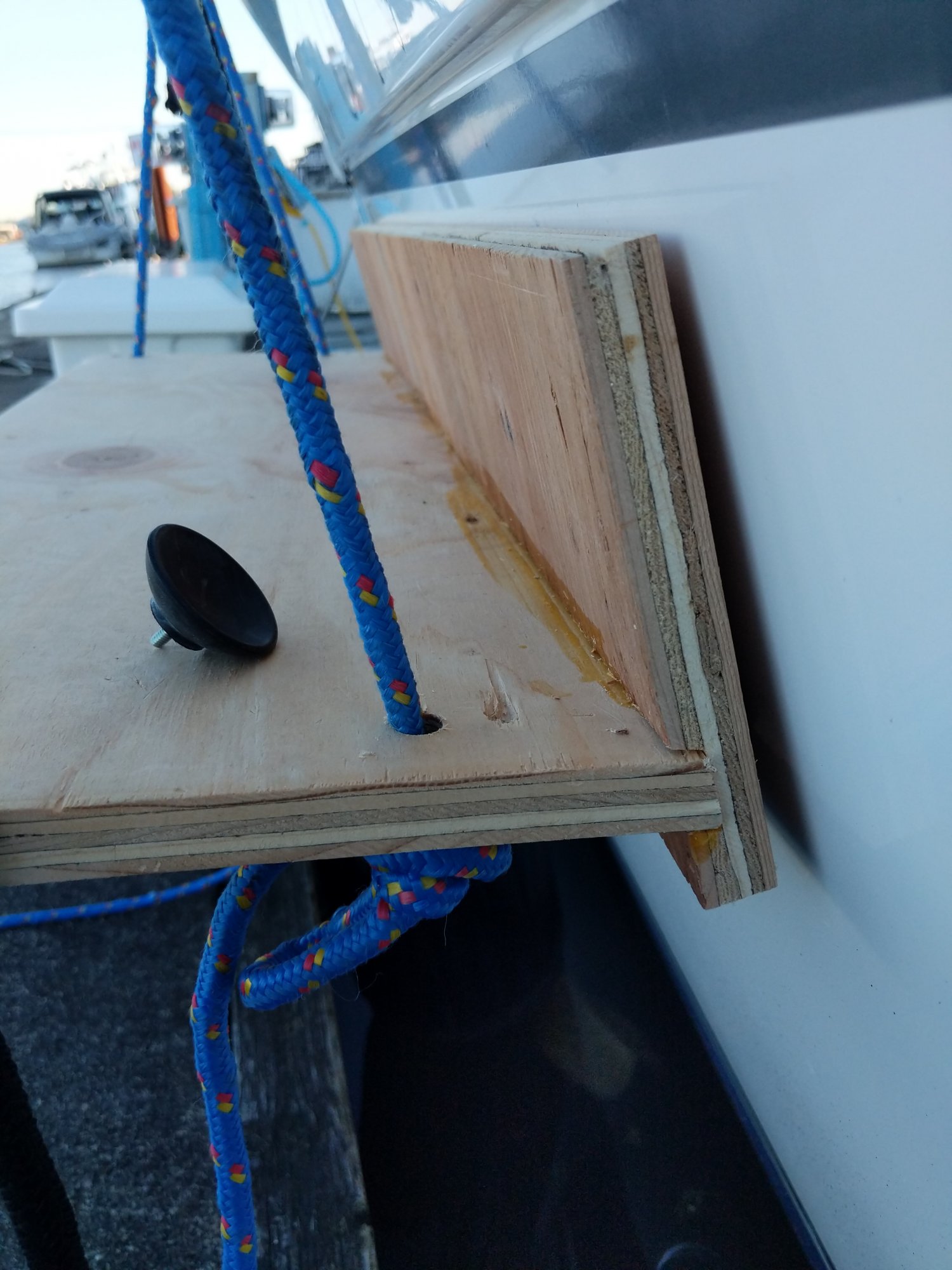

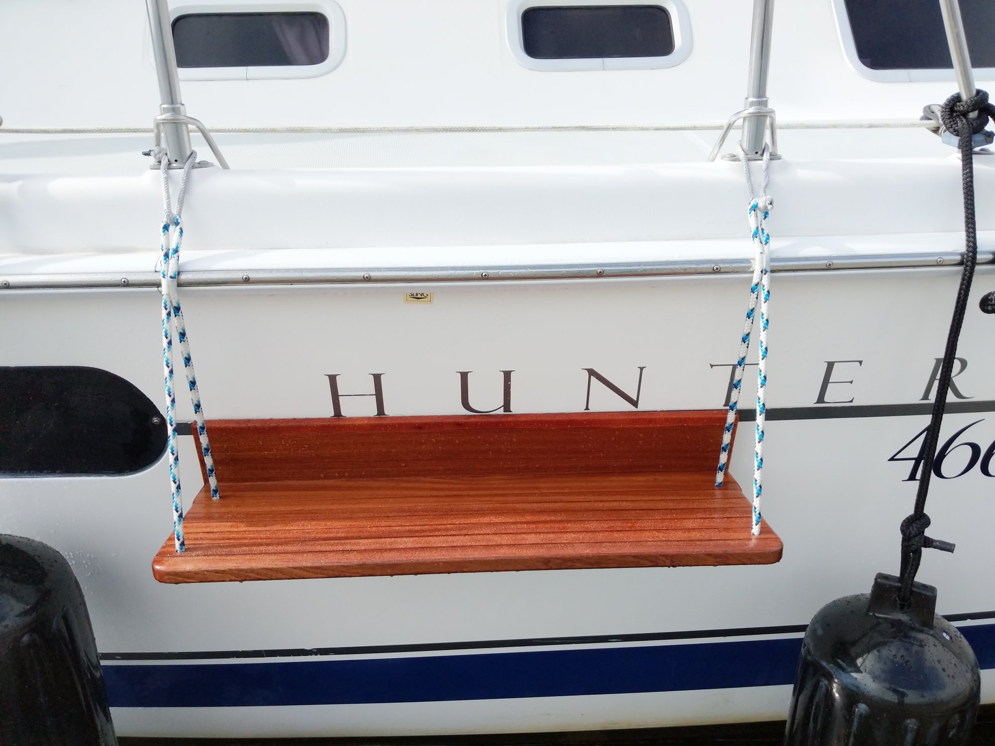

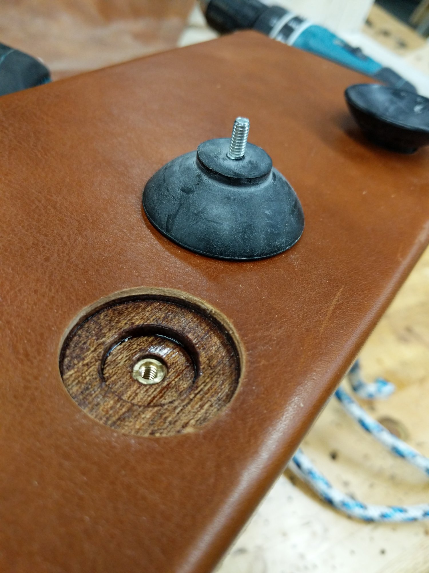

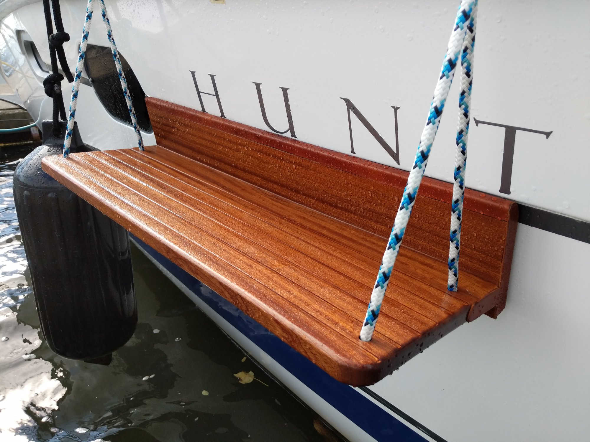

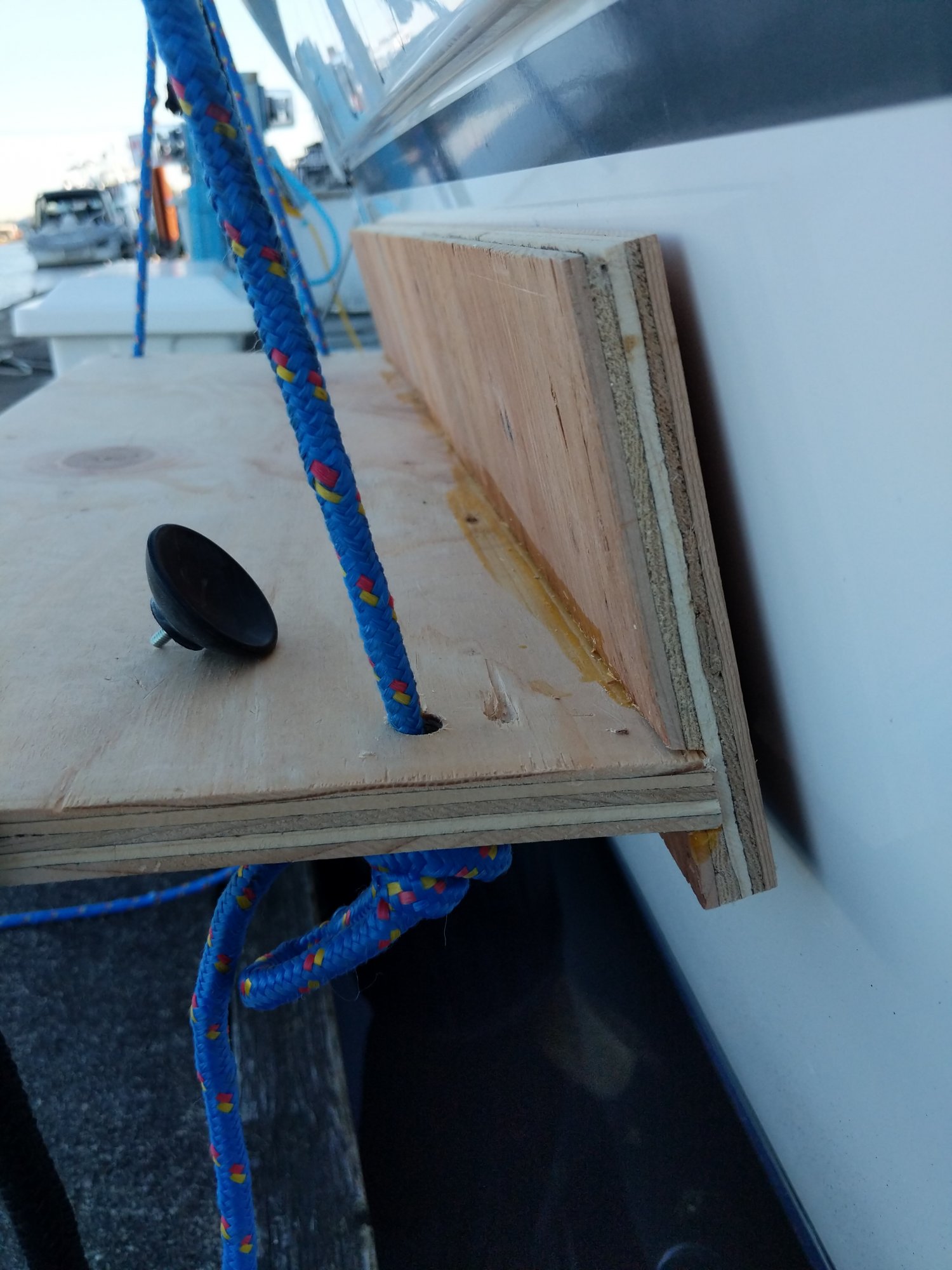

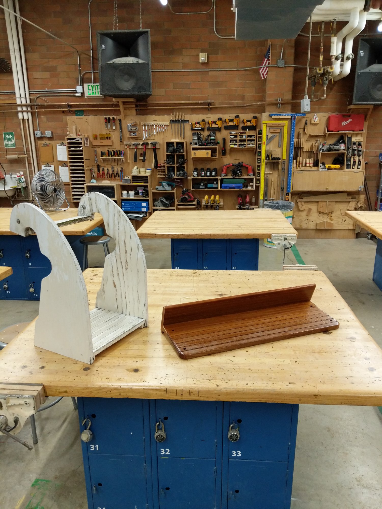

I purchased a Hunter 466 this spring and it came with a dilapidated rigid step that was made of plywood, was difficult to switch sides when needed, flaked paint off everywhere, and was nearly impossible to stow. After seeing Rich Stidger's step that he made a while back, I went to work and came up with a design that the admiral was happy with. I thought it would be straightforward to make... It wasn't. We designed it based off the design of the other steps inside the boat. The parts that touch the boat were covered with leather left over from the hide we bought for covering our steering wheel. Worked out the angles, put it all together, applied a spar varnish to it, and it didn't work! The toerail on the 466 extends out and pushed it out too far from the hull and it hung free and unstable until you put weight on it. After scratching my head for a while, a neighbor suggested suction cups. I THEN made a plywood mock up to make sure it would work. I recessed them into the back and they worked perfectly! Super stable, easy to bring in and switch sides (made some dynema soft shackles). This was a really fun project that took far longer than I thought, but hey, all projects take longer than my optimistic estimates. We went with 5/4 sapelle mahogany for the wood, contact cement to adhere the leather, "TreadTex" in the varnish for grip.

We had an aluminum step for our H356. It is quite a step up for these high freeboard boats. At times of very high tides it was difficult or impossible to board without it. But it was only about 10" wide. Making it stable was a challenge. Yours looks good and looks stabile. Nice project! Building something three times before you get it right isn't too bad.

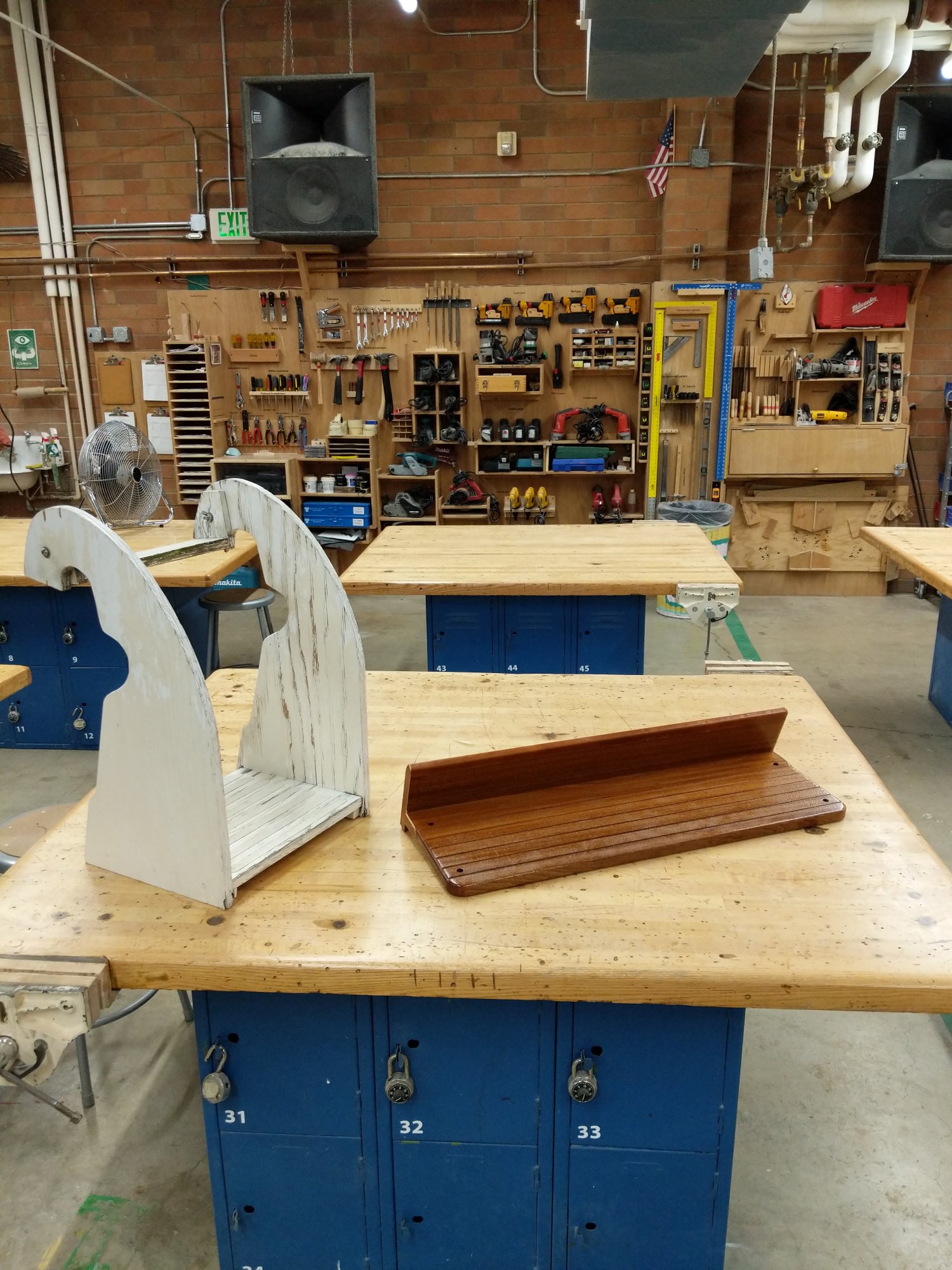

My thoughts exactly and very well equipped. Must be a shop teacher. :)
I teach graphics and photography. We just happen to have an amazing shop and even more incredible shop teacher. Out of our wood and metal shops we offer woodworking, construction, aerospace, and robotics. Some people have the impression that schools no longer do this, and while auto shop is becoming more rare, the trades are very much alive in our district.
