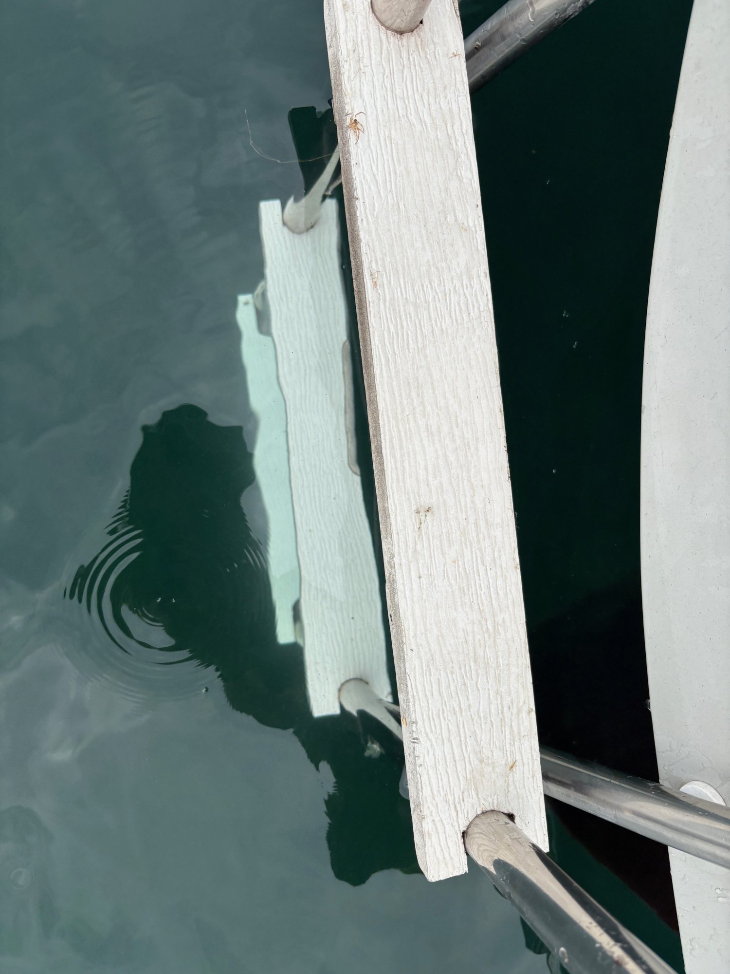

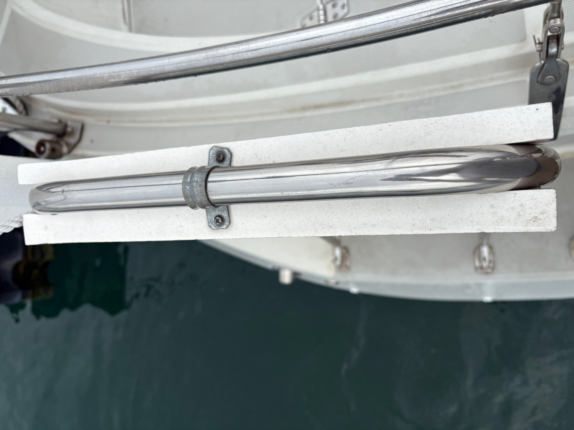

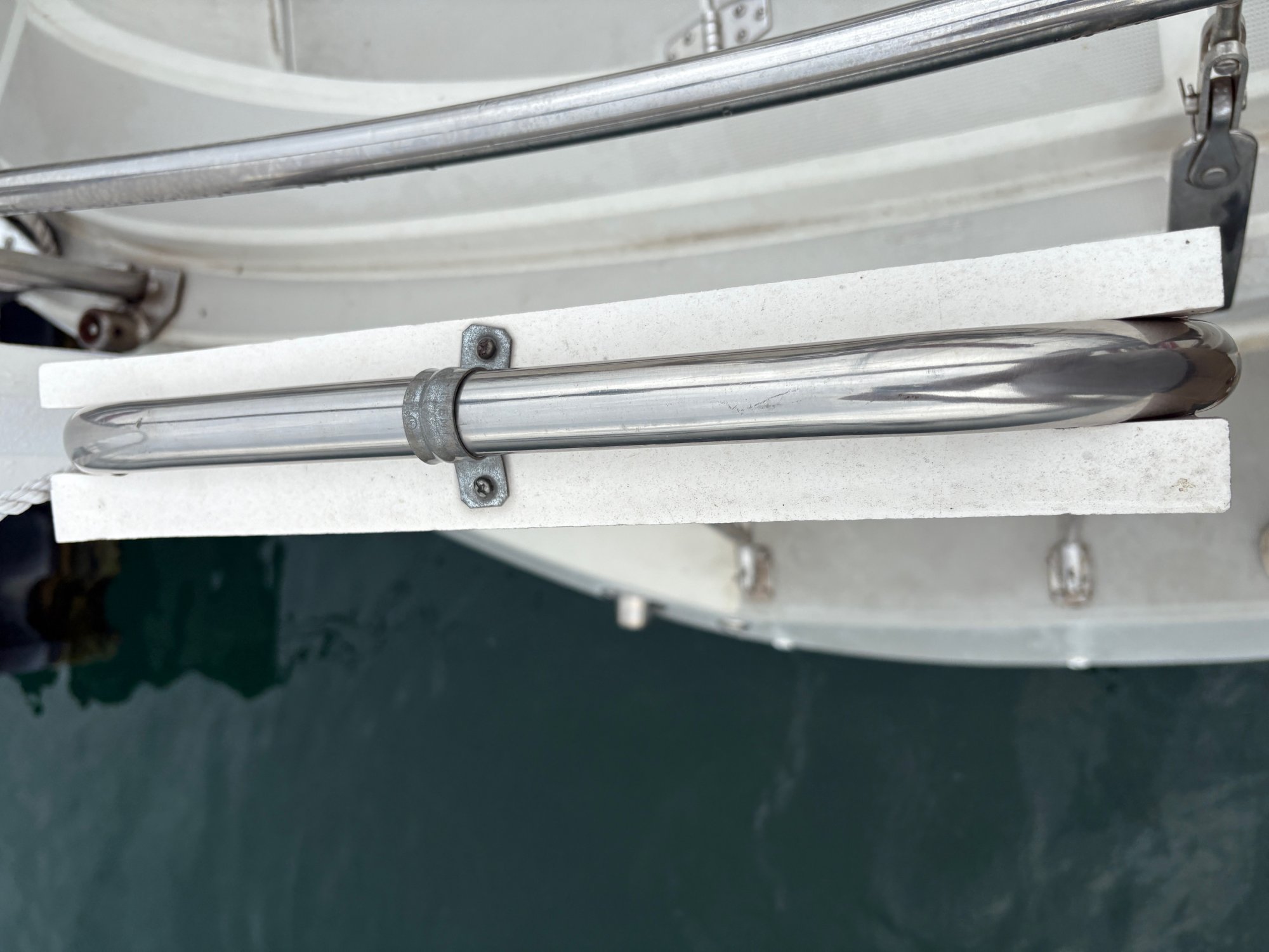

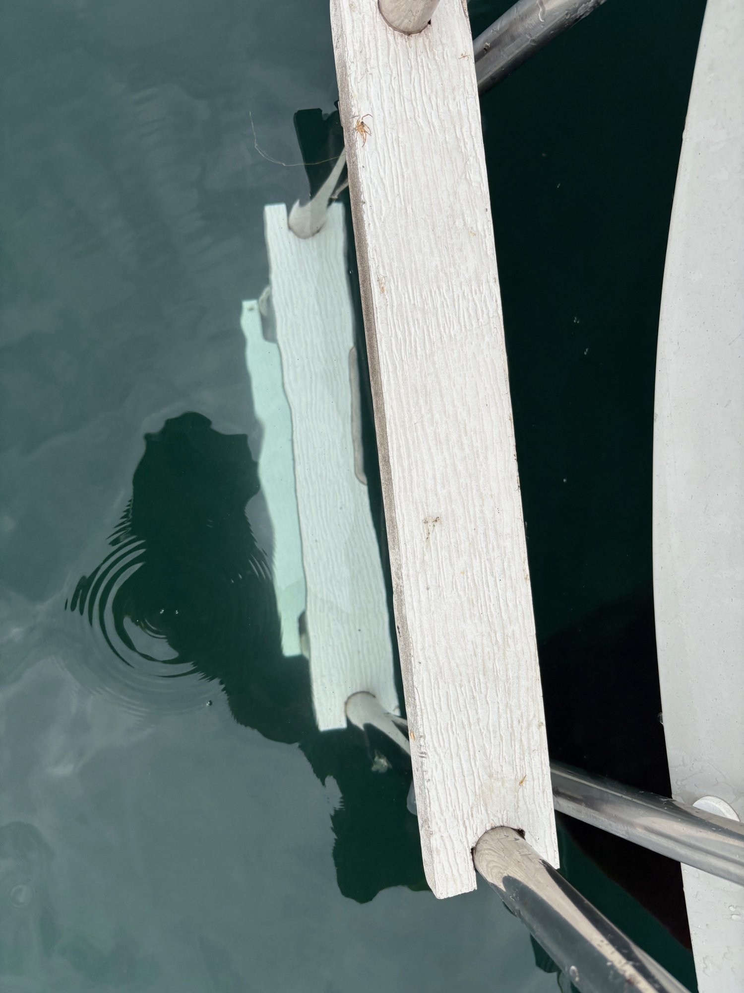

I cut some treads out of PVC wood and used pipe clamps to attach them to the metal rungs. Works great. It has been 5 years or so and no issues.
i cut the boards longer than the rung, and notched each end to slip over the vertical part of the ladder. This locks the tread in and it won’t “turn” on the rung. I will try to get a photo today when I am at the marina.

Here are some photos of my treads…
Greg

It is some sort of synthetic board used in house trim. I got it at my local big box lumber yard. Embossed with wood grain, but essentially some sort of plastic.
I think teak could be used the same way if someone really likes teak. I have been removing and replacing teak where possible as I hate to maintain it.

Hey Fred,
I used a PVC trim board from my local big box lumber store, and ripped it down to the width of the tread. I wanted it wide enough to wrap around the ladder tube to provide some stability without having to drill holes in the ladder tubing. I cut the tread to the width of the ladder, including the vertical tube, and then notched out the tread at each end so it would fit between the vertical tubes. Then, to keep it there, I put a pipe clamp or 2 under the tread.
Pretty easy and no drilling into the stainless ladder.
Greg

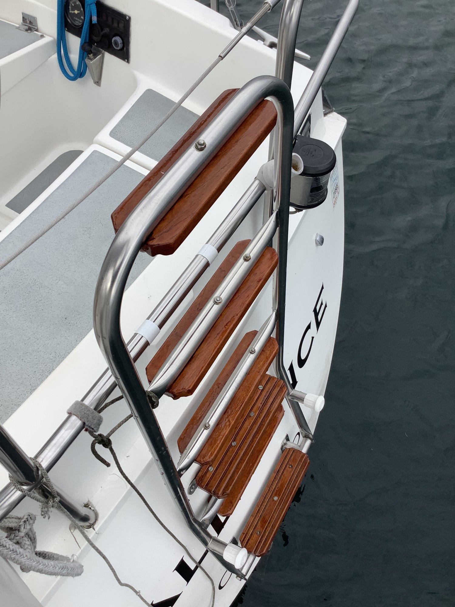

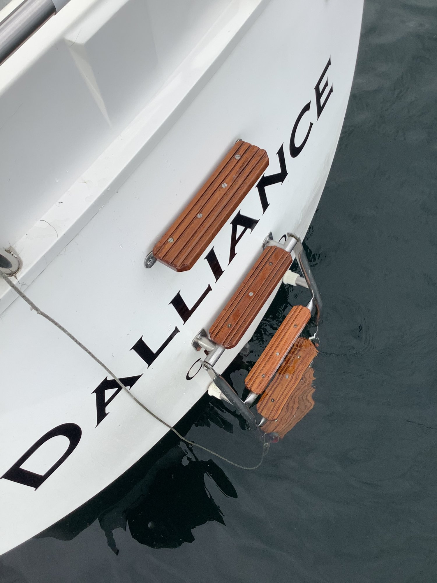

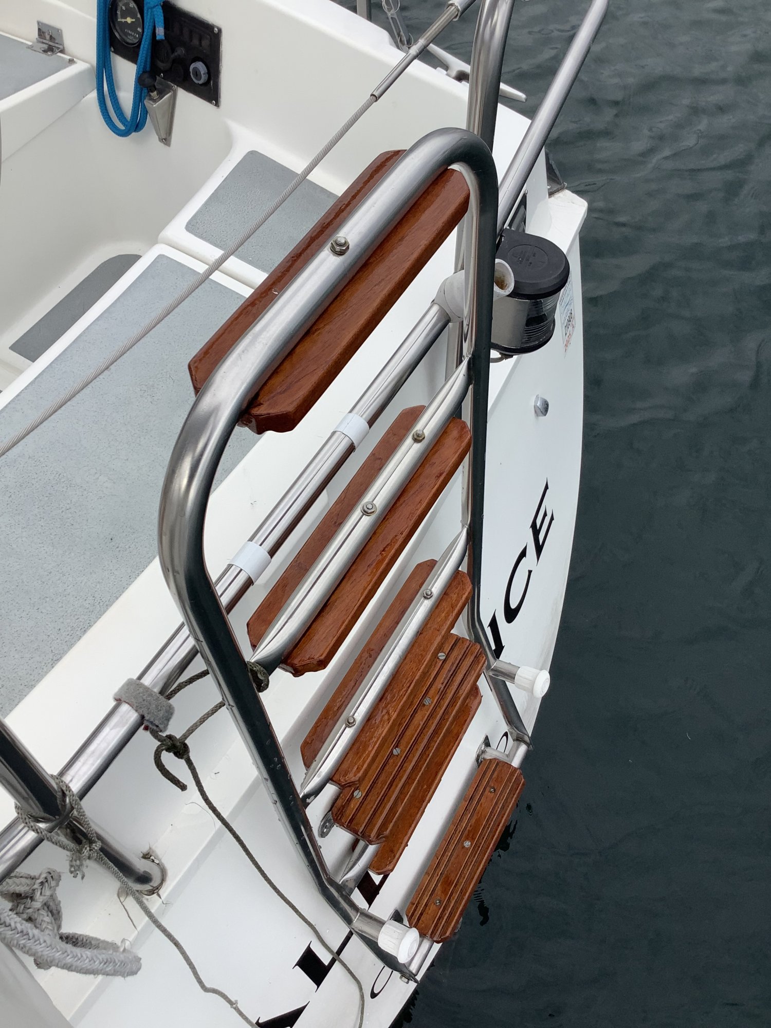

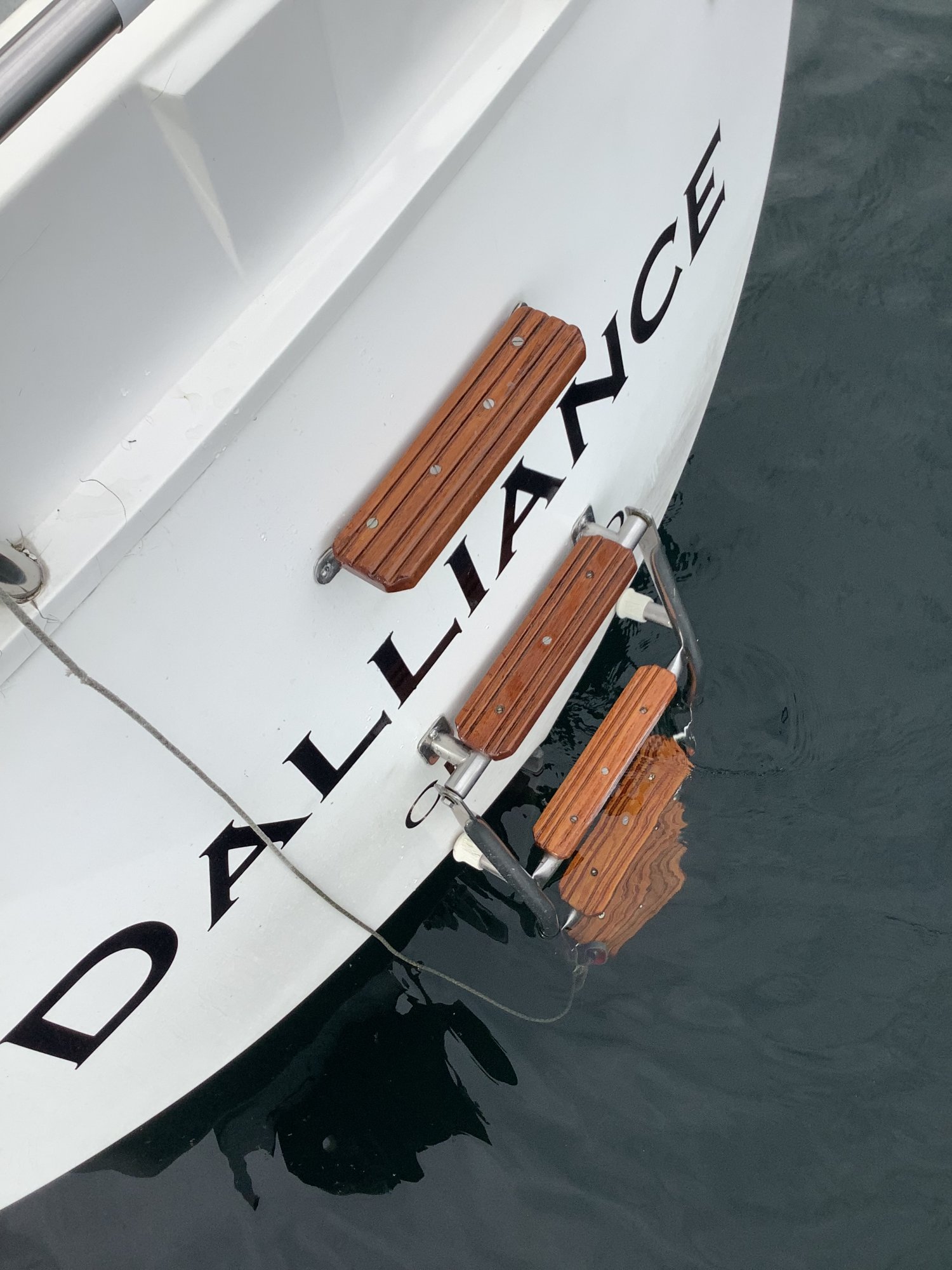

The previous owner of Dalliance made teak wood treads for the swim ladder. The top faces are grooved for grip, the underside of each tread is routed to fit the round ladder rungs and they’re bolted to the stainless steel tubes.
I’ve always had some concern about the possibility of water entering the tubes and freezing, but these went on the boat 30 years ago and it hasn’t happened yet. They’ve been removed and refinished multiple times over the years.
They’re beautiful, but if I was doing this project myself today, I would probably do it exactly the way Tally Ho has. Likely with white StarBoard.
