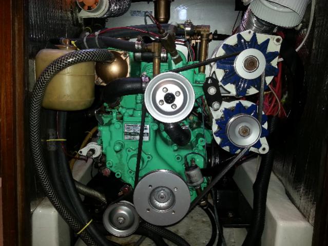

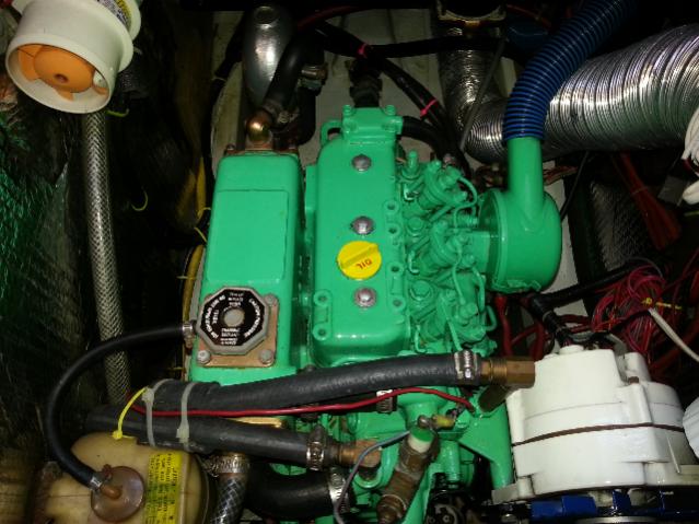

Mine came with a factory exhaust blower (orange hose), I think to get rid of excess engine heat, also a they included a fresh air engine intake (grey hose) because of an engine fire suppression system. It works well to keep the boat cool after a day of motoring.
A few hundred pounds of cast iron radiating heat for a couple of hours after you set the anchor can warm up the cabin in a tropical setting.......
