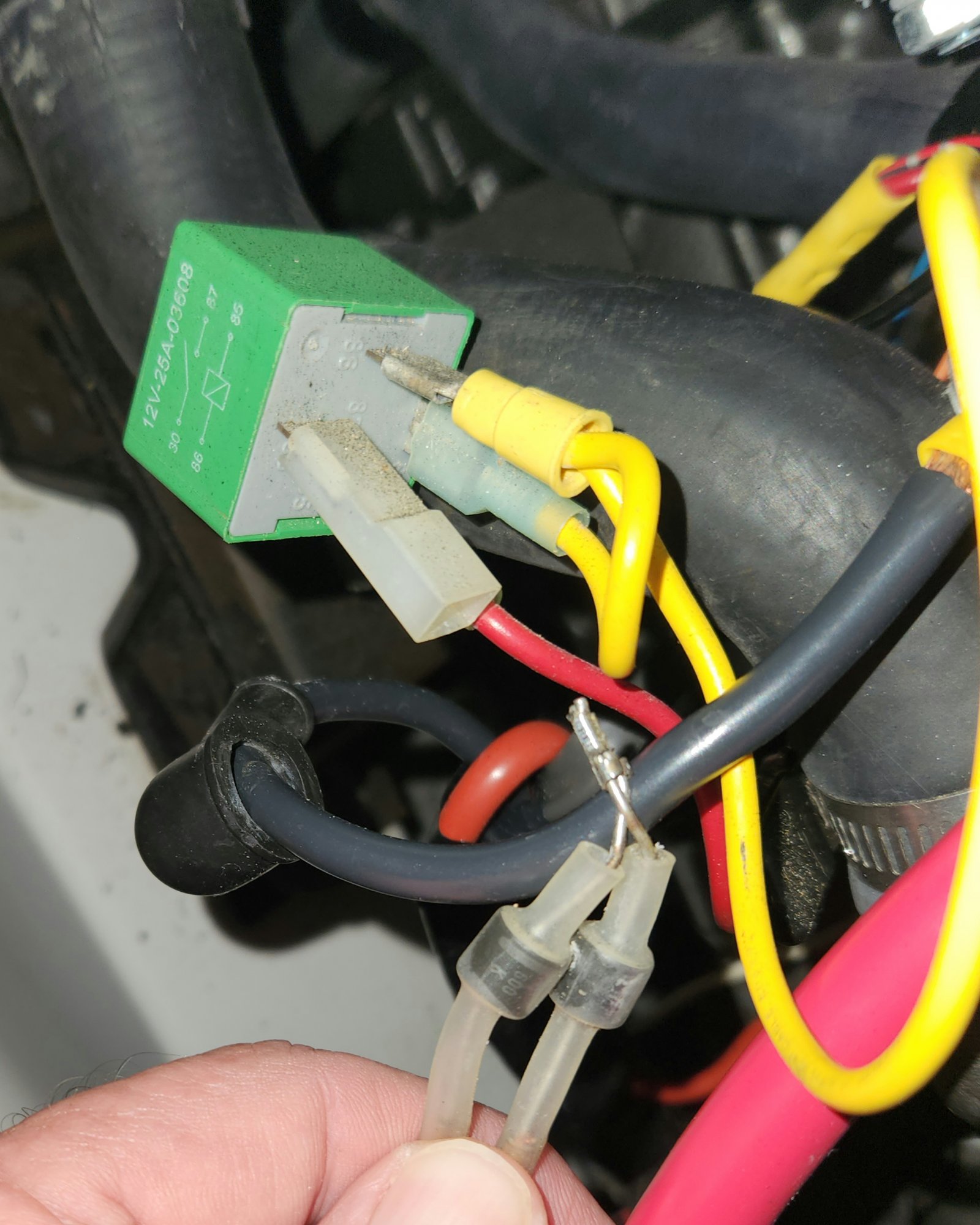

On a 2016 Beneteau 370 with a Yanmar engine. The blower is not starting up when I push the power button. Normally the blower comes on when I push the power button. The blower starting signals the alternator to turn on. Since this is not happening, the alternator does not come on and when the engine starts the battery light stays on and keeps beeping. Any suggestions would be helpful.

Do you remember the title of the thread?
Also, what was type of boat/engine and what ended up being the issue?

The broken connecter (wire) was the problem. Look closely at that photo I posted.
I don't remember the name of the thread, I'll look for it. It was mostly just a picture of the broken wire.
