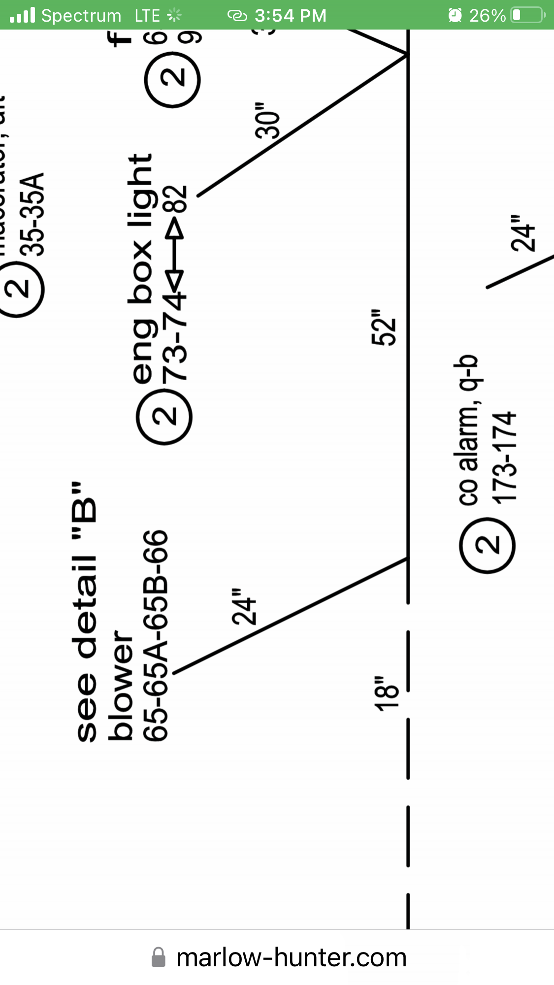

I looked at a wiring diagram for the 45cc and followed that. Now my blower comes on when I flip the switch up. But when I flip it down and turn the key to start it doesn’t run!
If anyone can take a picture of the relay connected to their blower and post it here so I can see how they have it wired that would be much appreciated then at least I would know if my wiring is correct or not and then maybe I could start looking somewhere else for the problem…
Also I’ve included a wiring schematic for the Hunter 49 but where the blower is it says to “see detail B” and I have no idea what “detail B” is if anyone knows what that is and can post a picture
that would be great…

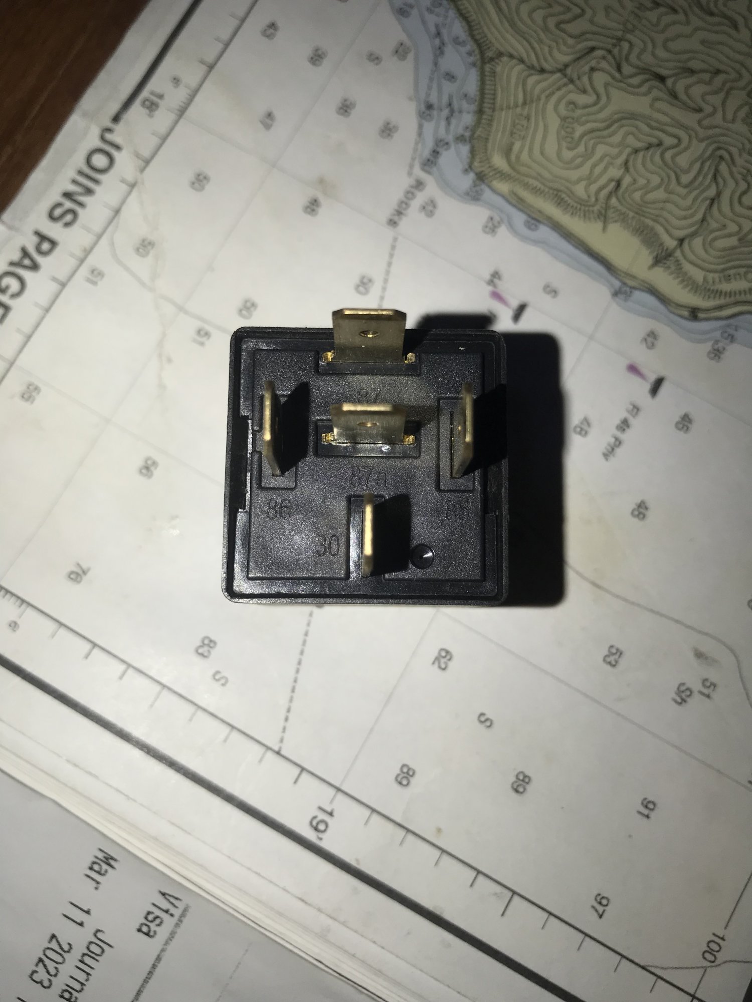

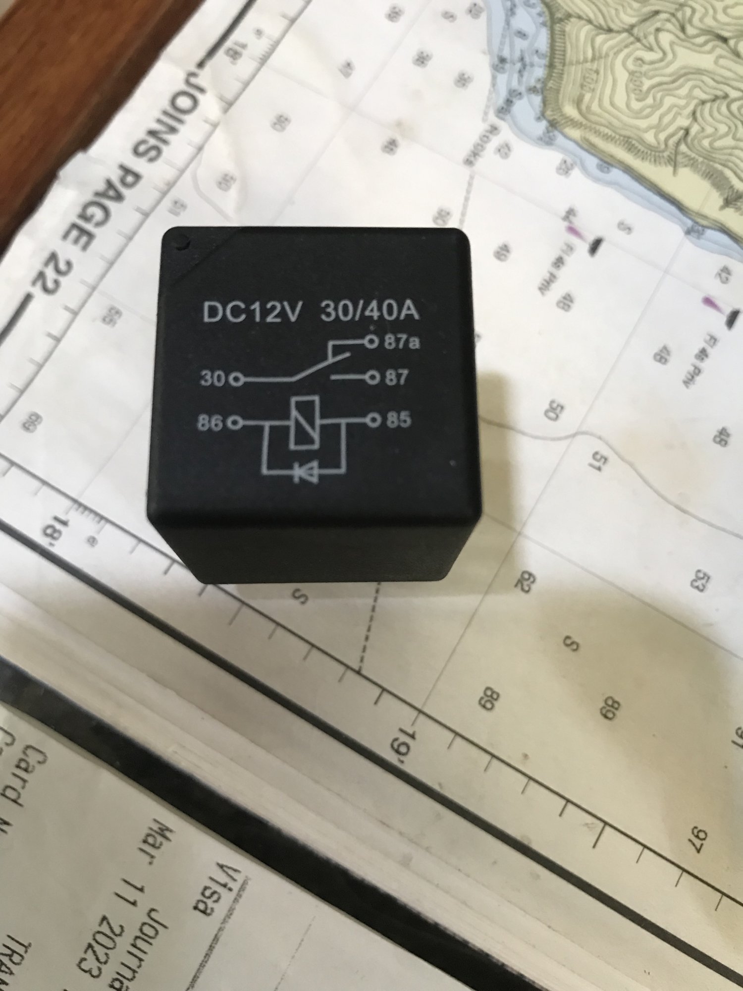

Also here is a picture of the relay I have I replaced the faulty one that was in there but who knows maybe this one is wrong and maybe that one was wrong…99785779-BC94-4AB2-9A33-B4A46D5AE149.jpegABAF1AA4-8369-4DE6-9C37-CA002676E122.jpeg
