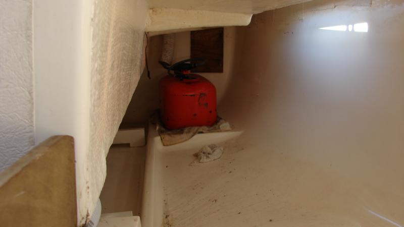

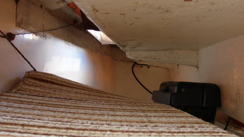

Your under-cockpit area looks rather like my O' 25. My portable tank has always been strapped down there, too.
To answer your question directly, it seems to me that blowing air IN would force fumes into the cabin.
That said, I need to build a restraining system for the gas tank into the cockpit floor to avoid those bilge-fume problems. I may have been lucky or not, but my problem was the Saltines tasting like gasoline. Yech. The vapours drained along the bilge, and through the cabin lockers on the way to the keel sump. Stored foodstuffs soaked up those delicious petro-flavours.

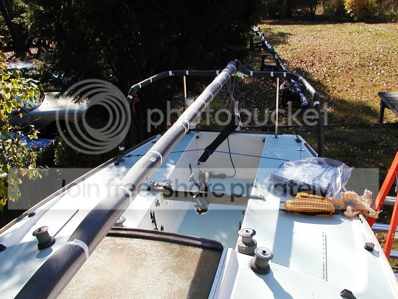

This is one of those that is the way they use to build ALL the small boats right up through J80s and many others
As a matter of fact they still build the J24/J80 THAT WAY and the official place to store the motor during a race is in fact INSIDE the cabin
And i am pretty dam sure when we test sailed the New J70 THIS SPRING there was no fuel locker
Myself and the 5000 other J24 owners kept the fuel tank in the lazaret and put it on deck to run the motor and then stowed everything during a race
The lazaret keeps a stable temperature VS a plastic fuel tank on deck in the sun with the vent closed for storage which will in fact expand to the point of almost failure
