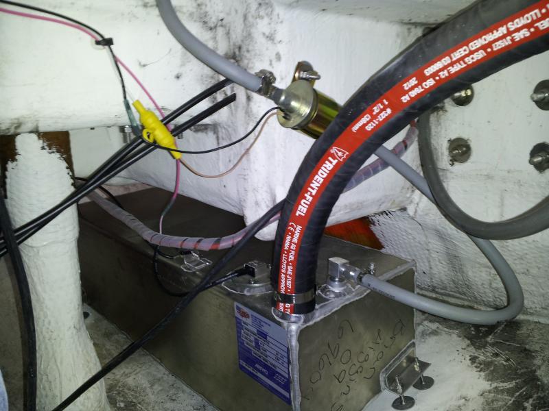

The trip gave the new fuel system, 4 blade high-thrust propeller, and auto pilot one heck of a good workout, and all performed spectacularly. The new tank holds 9 gallons, and I carried a 5 gal jerry can in addition. Coincidently conditions dictated that I burned almost exactly 11 gallons of fuel each direction motor sailing, with an average of 14 hours of time on the engine each way, with some of that at high RPM to power through heavier seas (heading out) and strong current (returning through the race), for an overall average of just under 0.8 gal/hr, with consumption at normal cruising RPM closer to 0.5gal/hr.

While the fuel tank upgrade I did this year really simplified that aspect of the journey allowing both the longer range and most significantly the easy monitoring of the fuel level as well as an excess of 12 hours of engine runtime before pulling out the jerry can, and the auto pilot made it possible to double hand the trip without too much stress or lack of sleep, the real amazing upgrade that made the passage so easily achievable was really the new propeller...
New Fuel Tank

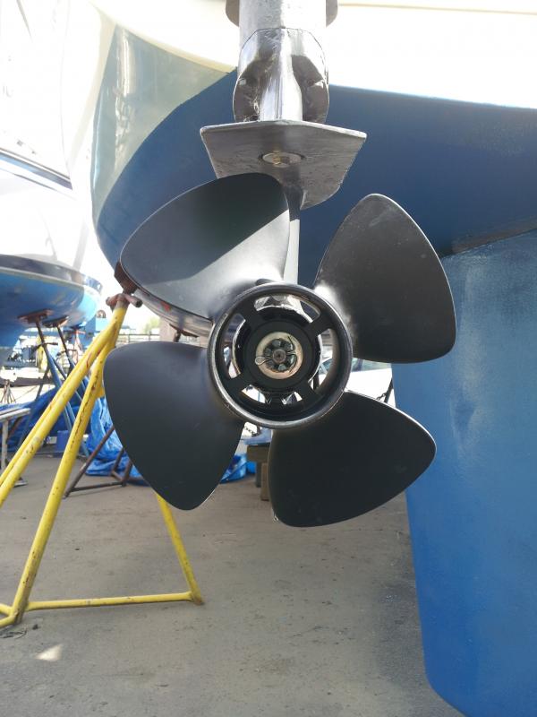

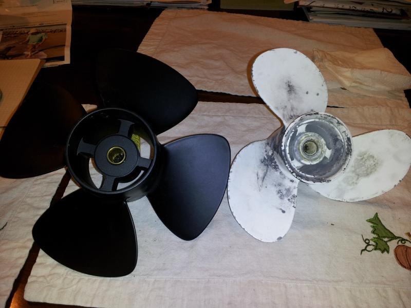

The difference in motoring performance after switching from the standard 3 blade to the 4 blade high thrust prop is nothing short of amazing. When we left Stamford on Thursday evening the wind was ~12kts straight on the bow, and seas were 3-5ft, coming straight down the sound with over 70 miles of fetch to build through. The bow was going airborne and smacking down every few minutes when a particularly large wave came our way, and more than a few times the bow buried into oncoming waves. You may question why we left in those conditions, but it was only 12-13kts of wind, I didn't expect the waves to have built as much as they did, not to mention it was forecast to die out over night starting a few hours after we left, building again from the west in the morning, which it did. Despite the rougher than anticipated conditions we were still able to maintain 4kts+ of speed over ground, without pushing the engine too terribly hard. With a 3 blade prop we would have struggled to maintain even 2kts of SOG, and the prop would have been cavitating badly in the chop. Even motor sailing on a port tack (engine is on the port side, so it is higher in the water on a port tack) the 4 blade prop did not cavitate except in the most extreme angles of heel, and never once did it do so badly enough that I needed to back the throttle off to prevent the engine from over-revving.
The overall takeaway here, anyone running an outboard with a normal 3 blade prop should immediately try to find a 4 blade high thrust for their engine, and if you want to take a longer trip, absolutely invest in an auto pilot. I couldn't have done the trip without the two.

Who made the prop? Those symmetrical-looking blades probably also give you pretty good reverse, at least compared to the original.

Prop has a Tohatsu name and logo stamped on it, but the box it came in says Amita 4 on the label, which is a SOLAS brand, so I'm guessing Tohatsu just contracts them to make some with their name on it. I picked it up from boats.net for something like $65. (EDIT, here's the link http://www.boats.net/parts/detail/props/T-3B2B645120.html)
As for reverse, it actually feels like it accelerates slightly better in reverse than it does in forward (maybe just in my head, but it does seem that way). My biggest problem with accelerating and maneuvering around the dock is that it moves so much water, it will create large whirlpools around the engine when powering up if the boat isn't moving, and sometimes suck air down into the prop. The problem goes away anytime you are moving over 1kt since the whirlpools cannot form quickly enough to reach the prop, and of course since it is moving that much water the problem doesn't last long because it only takes a few moments before the boat is moving quick enough to gain steerage.
Probably the biggest % boost to reverse performance over the 3 blade props is the oversized hub, which allows the exhaust gas to exit forward and around the gear case instead of aft and over the prop blades, thus allowing the blades to spin in clean water, not exhaust gas bubbles.
