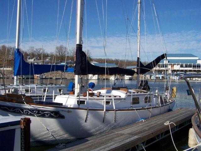

New member and first post- I recently purchased a 1977 Mariner Ketch that has several eraser-size blisters on her hull. The previous owner said the gelcoat was removed about 18 years ago and he had epoxy ever since. He hauls it and has the bottom painted every three years. Three years ago the hull was stripped and 6 coats of West System epoxy applied and 3 coats of bottom paint. Now=blisters. My question is this....What is the sure fix for this reoccurring blister problem? And what if blisters go ignored? The boat is on the hard now and I'm trying to figure out what course of action makes the most sense. Any help will be greatly appreciated.
