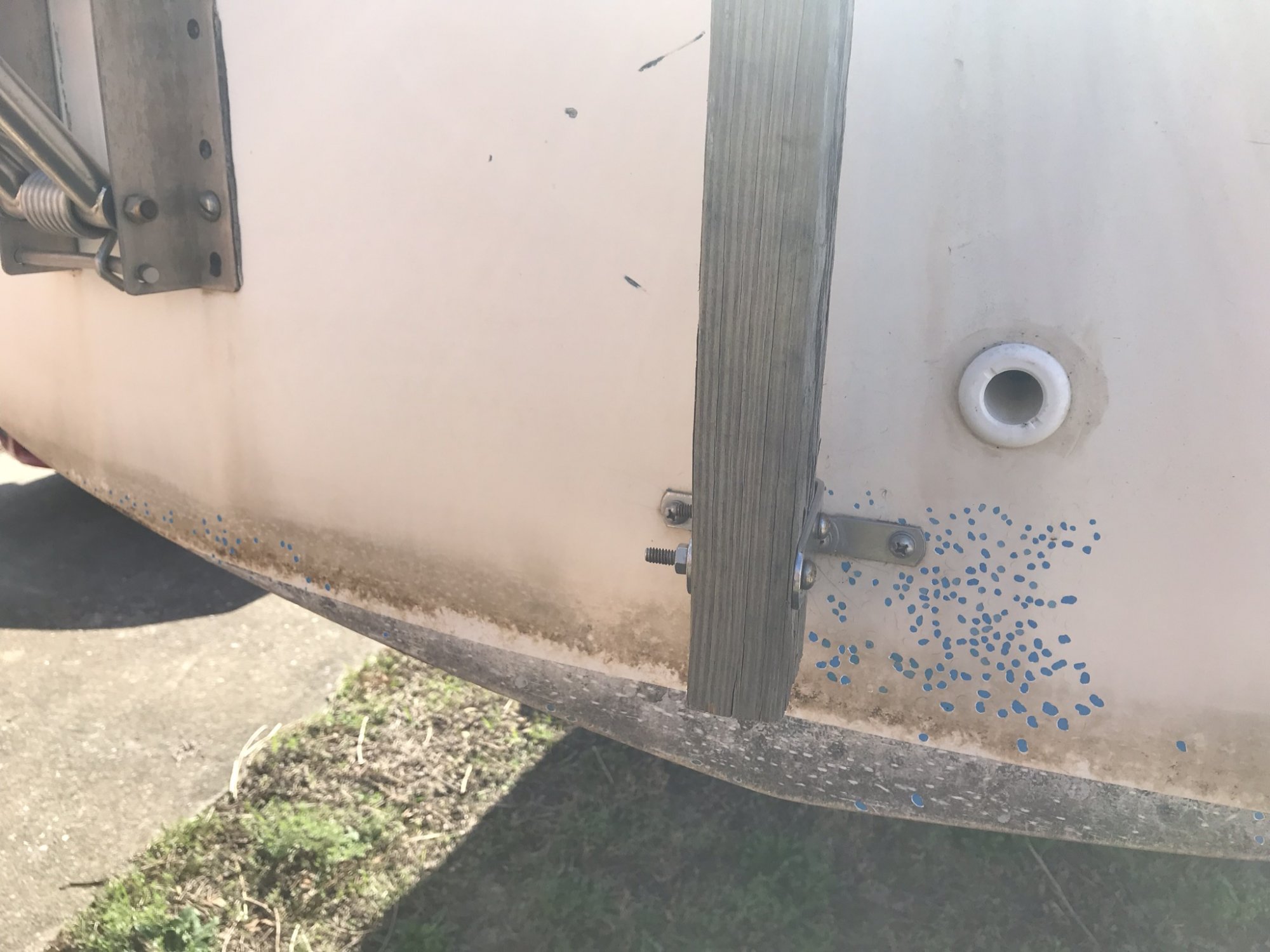

The pic shows the transom where some of the blisters were "popped". The depth is about fingernail thickness.
In the photo it looks like there were some popped blisters under the bottom paint and no blisters appeared below the paint line for me, just within about an inch above. The boat has been out of the water since Oct. 1 so the blisters have all dried out and returned to normal looking.

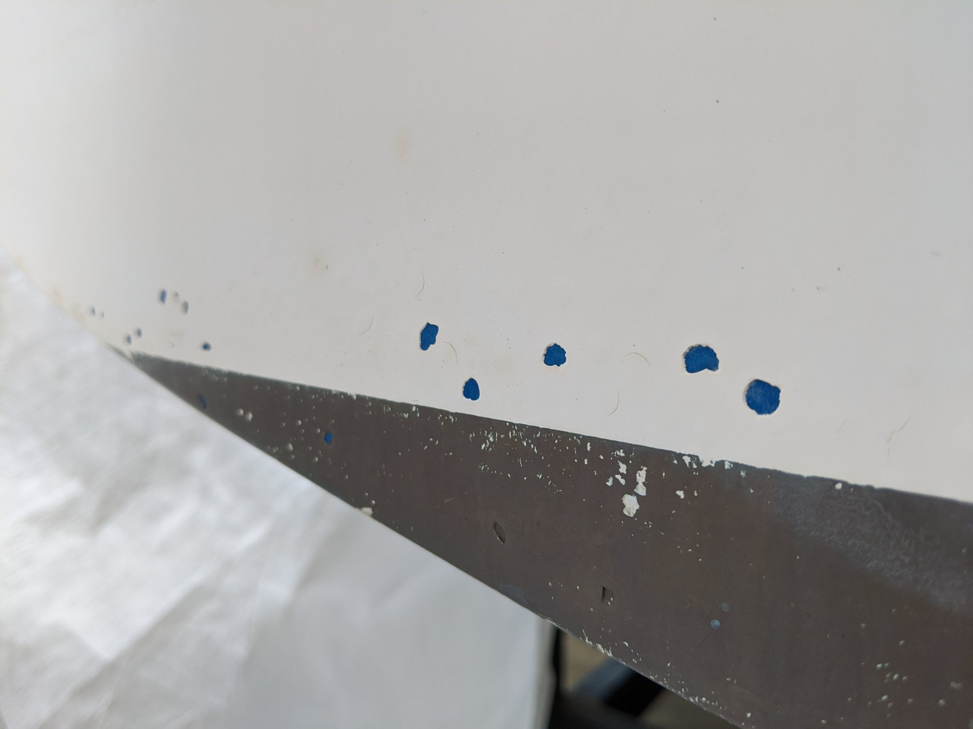

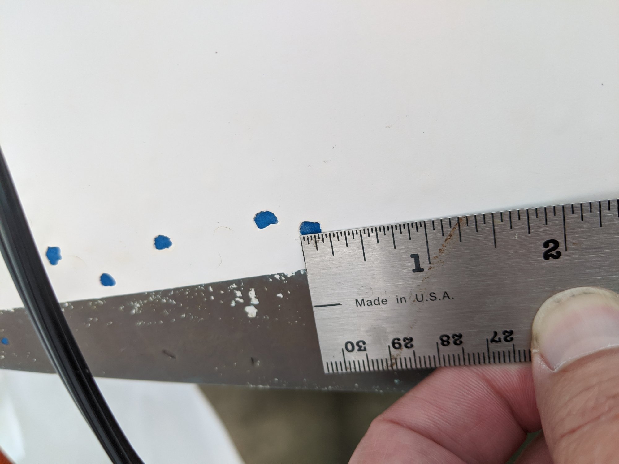

Maybe a photo with perspective might help. I am not sure how I could fiberglass such a small spot. The largest is about 3/16"

I'm not sure those are blisters, from the picture. You can have the "spots" patched, but you'll need to deal with UV problems if you use epoxy only. I would think you really need to replace it with some vinylester resin. I've not done that work myself.

Those don't look like blisters to me. No one "pops" blisters without the intention of repairing them. The edges are too sharp... and even if they popped on their own (which is very unlikely) you'd be able to see fiberglass. It looks more like "flaking" where there's been an adhesion failure. Either follow Gene Neil's suggestion, or send the pictures to Catalina customer service for their comment.

I had similar blisters, my fix was clean and bevel the gelcoat with a dremmel sander. Then fill with thickened epoxy and silica, about peanut butter thickness. MarineTec also works. Sand it down put a barrier coat on and repaint the boot stripe. If you don’t fix you run the risk of more gelcoat delaminating

I can attest to the fact that those are in fact osmotic bilsters that lift the gelcoat sufficiently to crack a crescent moon shape! Ask me how I know this... or take a gander at my thread!
Use a dremel and a small rounded cutting or sanding tool bit to hollow out the rot and taper edges of "pit" leaving a nice soft edge and smooth hollow pit. Keep it neat and tidy for minimal effort later. Then, as Gene has recommend, use some good old gel coat to fill right back up. If done nicely it is really as good as it needs to be for purpose of use.
