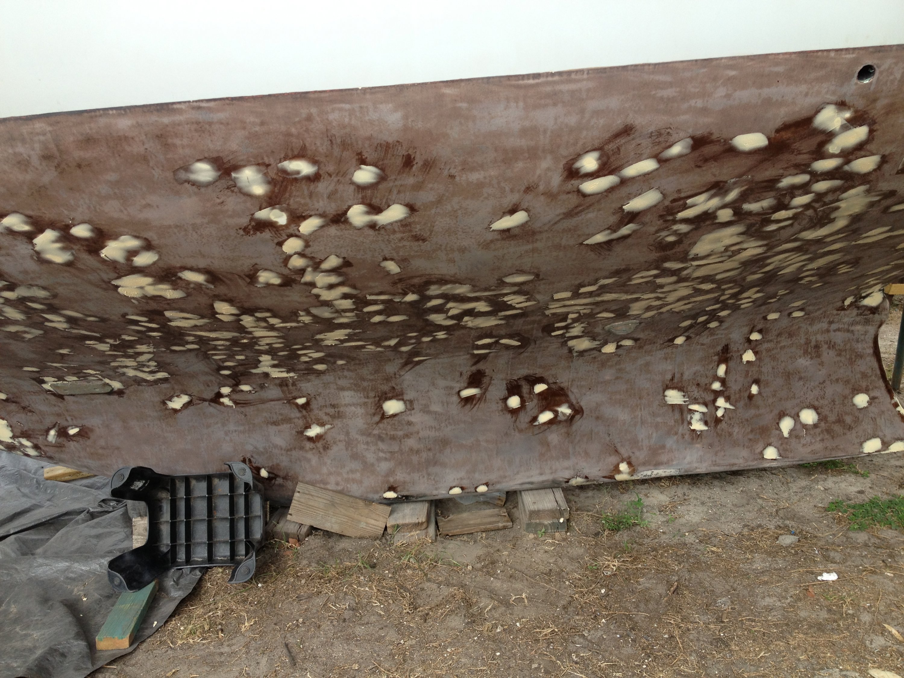

The boat was epoxy barrier coated in 2008 and has been in the water until this march, in Florida. There were a few hundred blisters about 1/4 inch. I sanded each one and they went into the gel coat but never penetrated into the laminate.
I call them barrier coat blisters. They were sanded out and filled with West System epoxy. I used just the resin and then came back with a resin and micro balloon filler. I sanded the spots and the thickness is very thin.
Now the bottom has a lot of spots but is otherwise ready for paint. I am wondering what to, do if anything.

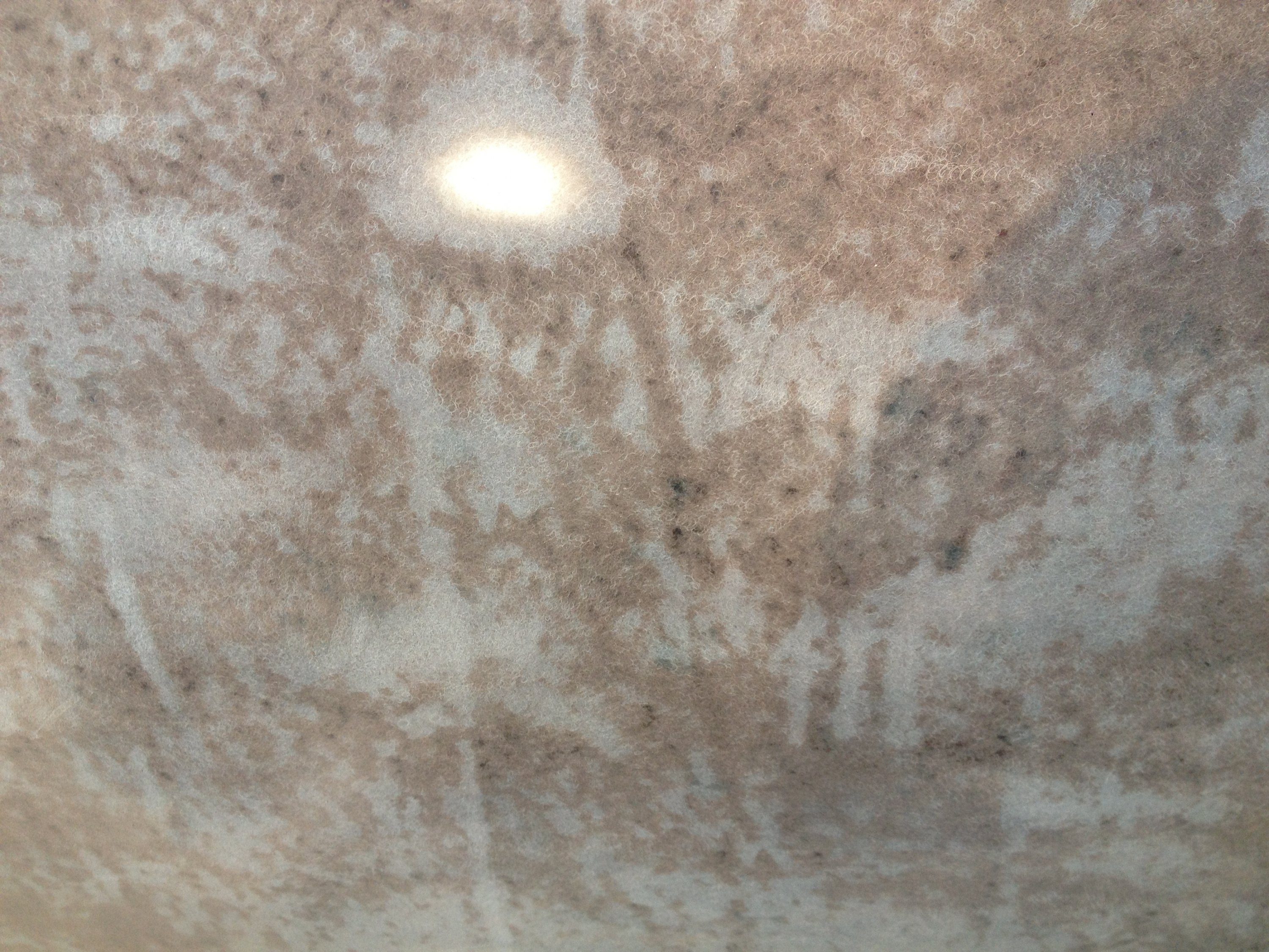

There were lots of tenacious barnacles that were scraped and sanded off. The gel coat was thinned in many places, so I decided to do an epoxy barrier coat as a primer to protect the gel coat (and laminate) from future wearing from sanding. I used rolled on West System epoxy, cant say how many coats or the thickness. I will say that I did a terrible job, with runs and sags all over the place. I did not know this until the haul out. I spend the entire month sanding the hell out of the bottom. The epoxy cured with a "mottled" finish. I sanded and sanded and would sand thru one layer of epoxy, yet still not have the anti fouling sanded off. Picture attached. Anti foul layers are brown and grey. Gel coat is whit and grey.
SO what should I do? I am thinking I need to use a primer to protect the bottom. But I am worried that I will have the same issue with blisters. I could use a non epoxy primer but epoxy is very hard.
I was thinking of Sea Hawk Tuff Stuff. I looked at a Sea Hawk video of the Tuff Stuff application, but was not impressed. The epoxy went on with a texture and not at all smooth....
Any ideas, experiences, and recommendations?
