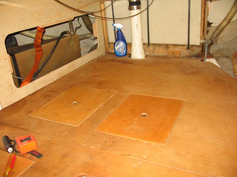

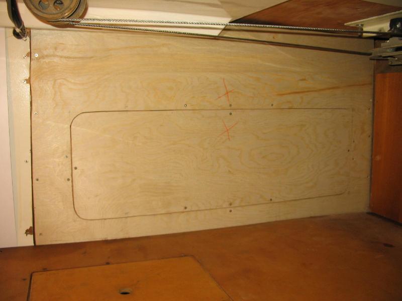

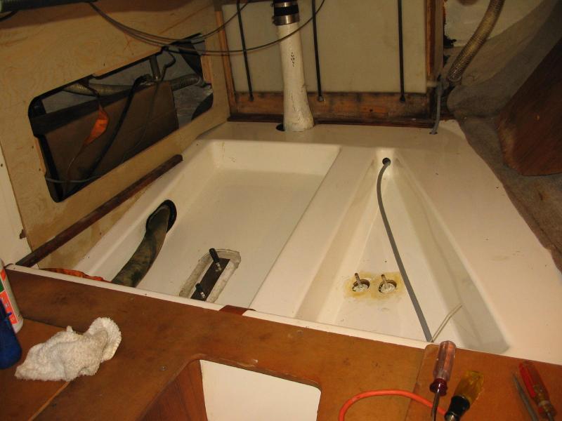

Don't want to steal this thread Claude,but I did just that a few years ago and am really pleased as it simplifies working in that pit when needed. It made changing that return line real easy. I still climb down in the pit occasionally however but have to remove my belt when coming out as the buckle catches the coaming and won't let me slide past LOL. Here are a few pics for you.
