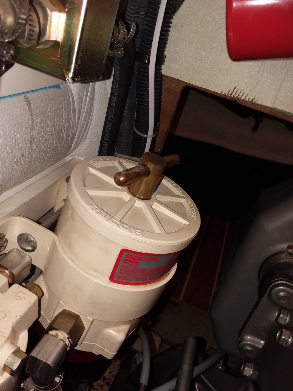

You have two fuel filters in that photo. A Racor 500 would be a custom install for that engine - you may be missing important fuel shut-off valves or they are not installed. Time to call a diesel mechanic.

This is a simple issue.... not a problem assuming this is all you did and it was running fine before. Don’t over think. Start at the beginning, turn off your fuel feed and open racor again and make sure it is full of fuel and that filter is pushed and seated in position. One thing that is great about these is that you can pour fuel in and can watch as it primes the hoses. Once that is filled put the cap on making sure it seats. I assume you replaced the gaskets that came with the filter and coated them with fuel. After you have the cap back on snuggly open the fuel feed.

Does your Racor have the priming pump on it? That moves more fuel and will fill the filter body and move the fuel to the secondary filter bleeder. Once you have all fuel (no bubbles) there, you should be able to start it. If not you have to start loosening injector nuts. Generally the engine is self priming once you get all fuel to the engine filter.
