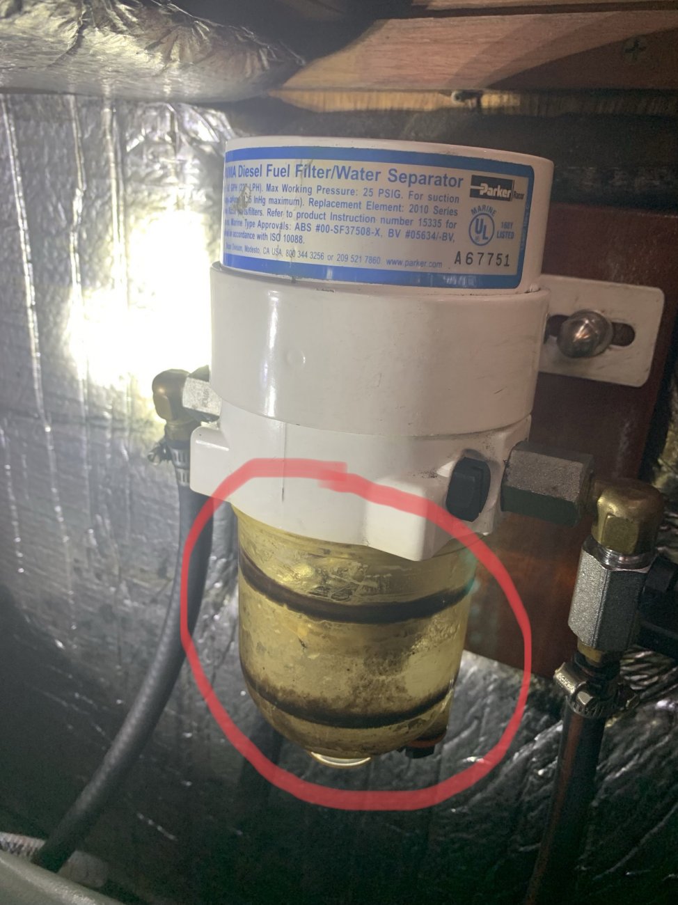

I’m having trouble removing the bowl on my Racor500 to clean up the stains on the inside. I’ve removed the retaining ring, but can’t seem to get the bowl to release.
Any suggestions?

The bowl is probably stuck to the gasket and housing.. may require some gentle prying and tapping with a soft face to get it to loosen after the retainer ring is removed. The bowl looks to be in need of replacement..?..

I’m having trouble removing the bowl on my Racor500 ...
Yea, some of those clear view filters are notorious for being hard to remove if they were screwed on tight. I've run into some that were so tight, right out of the box, that I couldn't get them apart & then had the sales guy try to get it apart, only to damage it in the process.
The deal is this -
Those things are rated for a lot of vacuum. In order to be leakproof all the way down to the specified amount of vacuum, they sometimes need to be pretty tight. After fuel has sat in them for a while, the O-ring will often swell & make the fit even tighter. After that, getting them apart just about requires an act of Congress & the effort of 3 men, 2 boys & a mule. This is assuming that you have the type with the threads on the bowl.
I have had my best luck getting those apart by wrapping the filter with a piece of rubber gasket material, then putting a strap wrench over that. On rare occasion, I have had to use more brutal methods. On a good day, I have gotten away with just using a pair of rubber palmed gloves. The cheap orange ones from Home Depot seem to work OK.
I make a habit of carrying a spare filter, bowl, & o-ring set, on any boat I have that uses a Racor. Trying to get a swelled O-ring back in place can be a non-starter. The diameter of the o-ring often grows by a half inch when it gets swelled from fuel exposure.

Update: I removed the Racor; brought it home; put in vice. Then, used a Oil Filter strap and Viola - - the bowl came loose in < 2 seconds. I'll reassemble with some motor oil and have already purchased a b/u o-ring kit for the 500.
