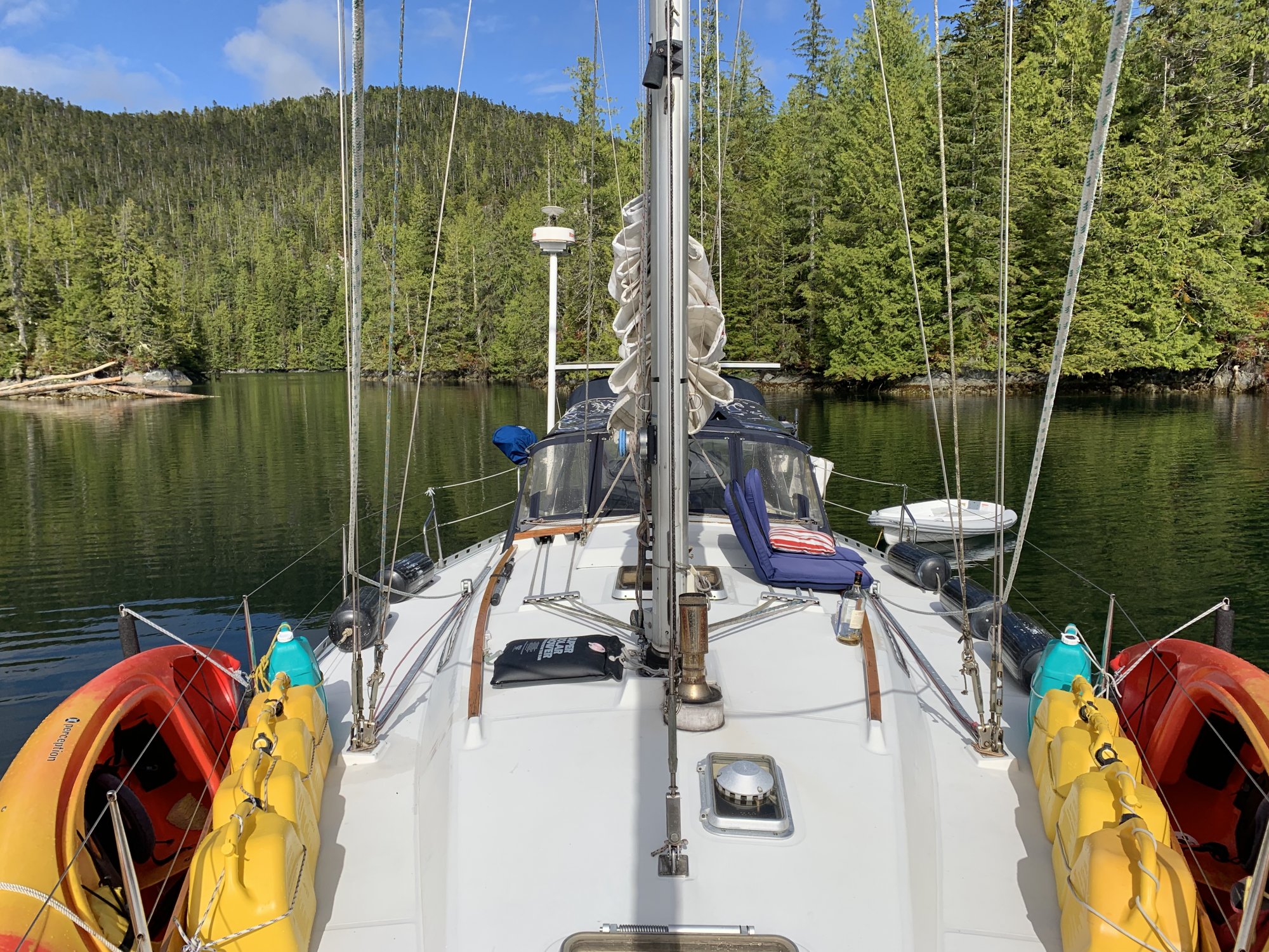

3E04E02C-C324-4710-A130-8429992D2E63.jpeg We also have limited fuel capacity. Not wanting to limit storage we opted for jerry cans on deck. The extra 40 gals has come very handy a couple of times.
Likes: JamesG161

Michael, looks like you and Bev have been relaxing on the cabin top. :biggrin:
Yeah, the hook is down and it’s time to relax. Notice the blue sky and lack of snow.......just to show we get nice weather( sometimes)
